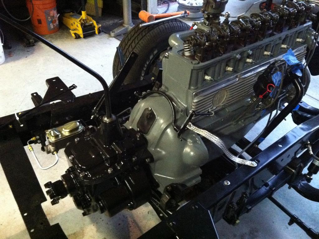

It's pretty simple ,
You connect everything up then slowly fill the resivoir , I like to gently push the brake pedal whilst peering in the open resivoir , just barley tapping the push rod -each time you tap it , tiny bubbles will come out the by pass port , keep doing this until they stop and you've " Bench Bled " the master without making any mess .
Always begin bleeing at the furthest cylinder from the master , this will usually be the right rear but maybe the left rear on your rig .
Connect a rubber hose to the bleeder nipple and stick it into a clear glass container (beer or soda bottle) so it touches the bottom .
