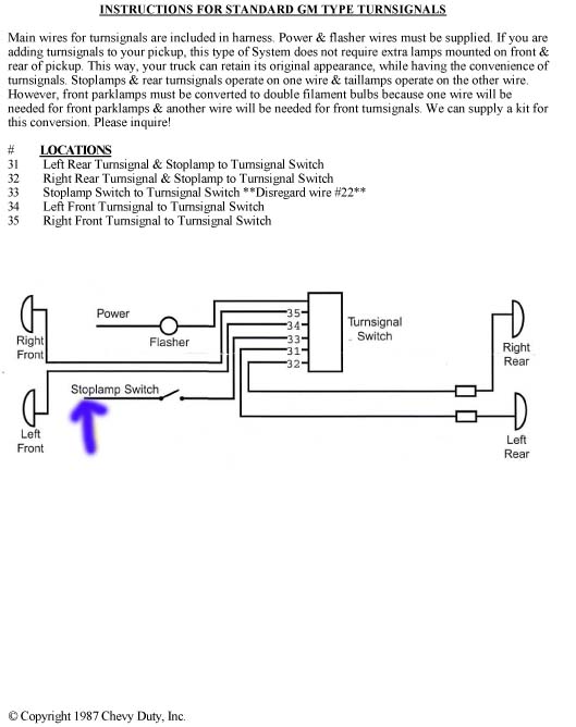

    Hello,
    where ends wire 33? Its the wire from turnsignal switch to the stoplamp switch.
    Where I have to connect it?

    It goes to the brake light switch which is mounted on the firewall next to where the brake pedal arm goes through.

    The stoplamp switch
    Hello Larry,
    the stoplamp switch has to pins, one is for wire 33 and the other?
    Wolfgang

    Wolfgang - On my harness it's #8 wire - power from a fused terminal. It doesn't matter whcih post you connect to.
