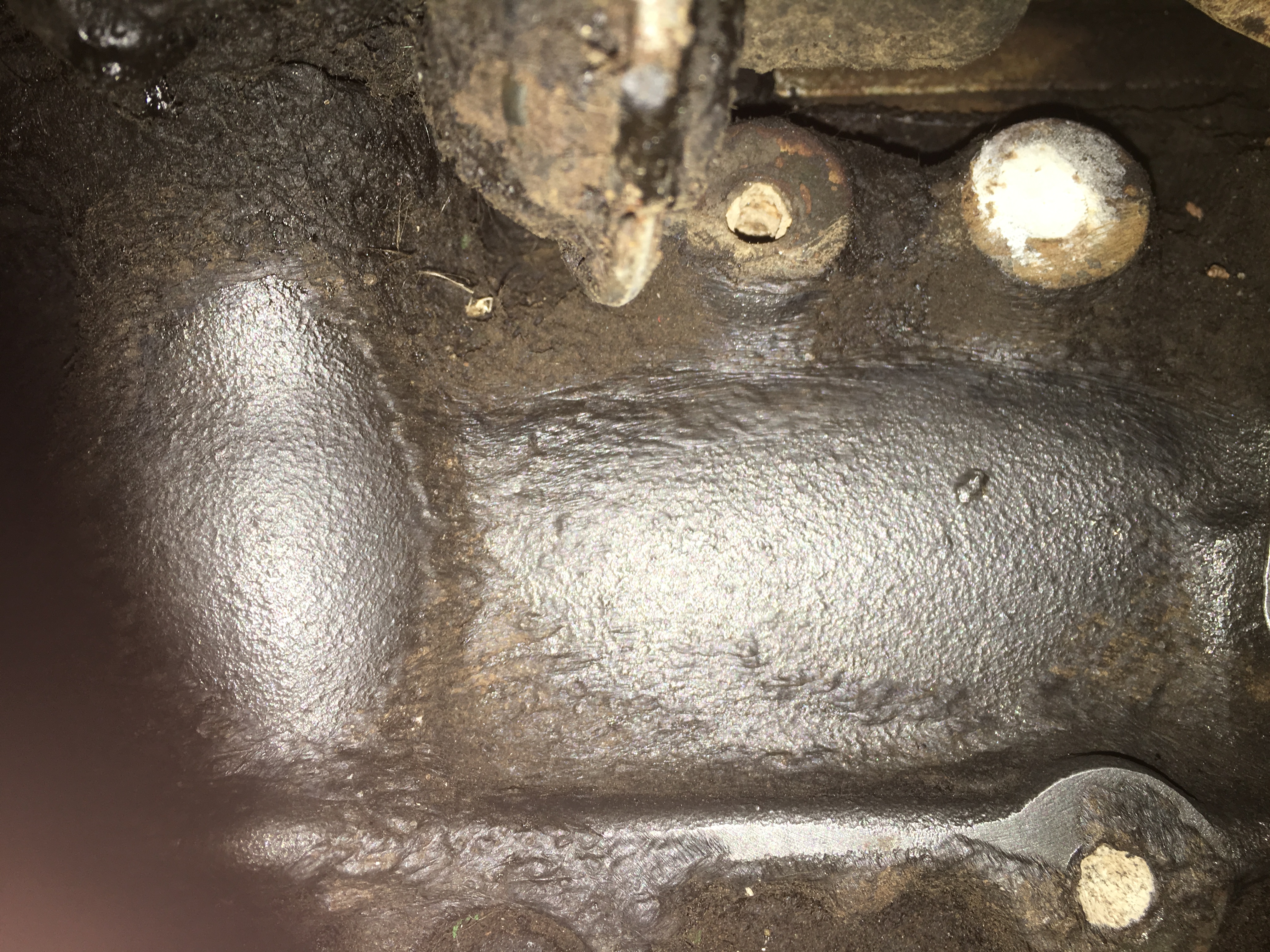

    It really bothers me that the code is not there. I went back out and played around some more to ensure I was not missing it. here is a picture that backs what I think. It is covered up.

    There is one number that matters to get you started down this road, then there is all the ancillary numbers that get things more pinpointed. The one you need is under the distributor and to the right. It starts with a 37 or 38 and is a 7 digit number. It is VERY hard to see since things are in the way, but there is no getting around its importance. It looks to be a 216 and it could be the original engine. Without the number, its just speculation. An original 216 may only have 6 digits. I find it very hard to see all of the numbers by looking down (under the hood) so if all else fails, slide under the engine and look from there with a good flashlight. This is worth the trouble because you should know those numbers to obtain the parts you may need later. Some people use small mirrors to check the number after doing major cleaning with a wire brush first.

  15. Deve
    Deve Member
    Jun 2, 2016
    109
    Hesston, Kansas
    The number has to be there. It may not be in exactly the same place because that was a newer style 235. Keep looking because it's the key to the actual year/make of the engine. My guess is it is the original 216 that came with the 1949. But without that number, not sure. The Head number means the HEAD only is a 1953 235 (the last babbit bearing, low pressure engine), but Heads are interchangeable. This would mean in all likelihood, the engine is a babbit motor, meaning its a lower pressure older style engine. Nothing wrong with that, but its a good idea to pin down exactly what you have. That number is the only way.

    Just to help me think I ain't missing these numbers I went out and removed the distributor and crank case vent. I still see no numbers.
    Would it be below the ridge, under the area I cleaned up?
  17. Deve
    Deve Member
    Jun 2, 2016
    109
    Hesston, Kansas
    Maybe its behind the plate the rebuilder put there, but I would not remove it. Could be a nice conversation piece when you get it rebuilt. With the head identified, you probably know everything you really need to know. Its either a 216 or 235 Pre-1954. That means it's the old style motor. What are your plans for the truck?
