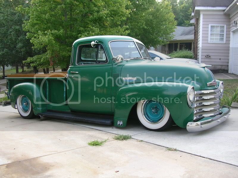

    Russ & Evan, thanks a lot for the info, it is a 265 manifold, if there is a hard way to do anything i seem to find it. it sounds like it might be easier to move the steering out a little and keep engine straight. Russ that is one nice looking ride! Are those buick headlights? you can see what i'm starting with on my avatar, not pretty just plain. Again thank you-Roy
  5. ol' chebby
    3,167
    53 buick rings, 57 ford hood ornament, Fatman stage 4 air ride front end, 8.8 ford rear from a 90 town car, 4w disc brakes, 350/350, 67-76 corvette master cylander, 55 chev. steering wheel. Stock frame
