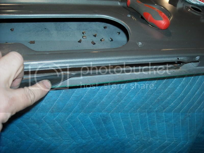

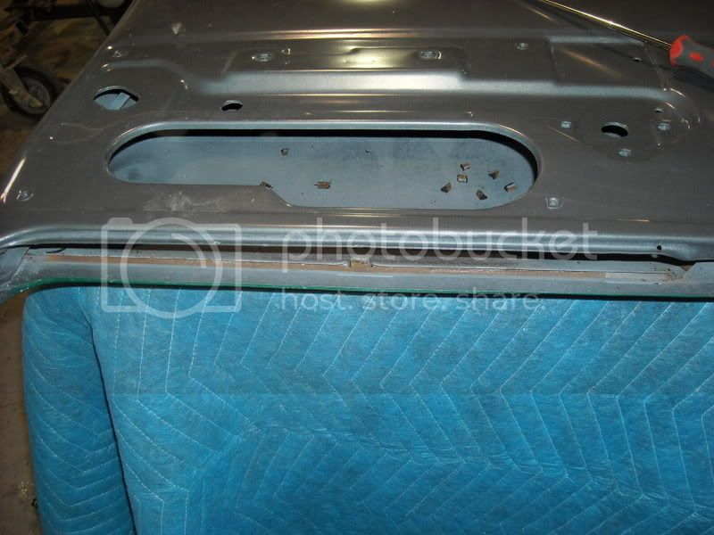

    This is where the rubber window wiper goes. It is usually dried and hard as a rock and broken off. I find that you have to bend up the tab in the middle, then with a flat blade screwdriver, break the rubber into pieces, then feed it out of the channel.

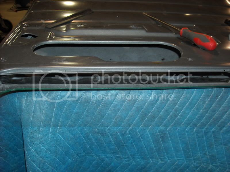

    Cleaned out. now lube the track.
    Feed one end,

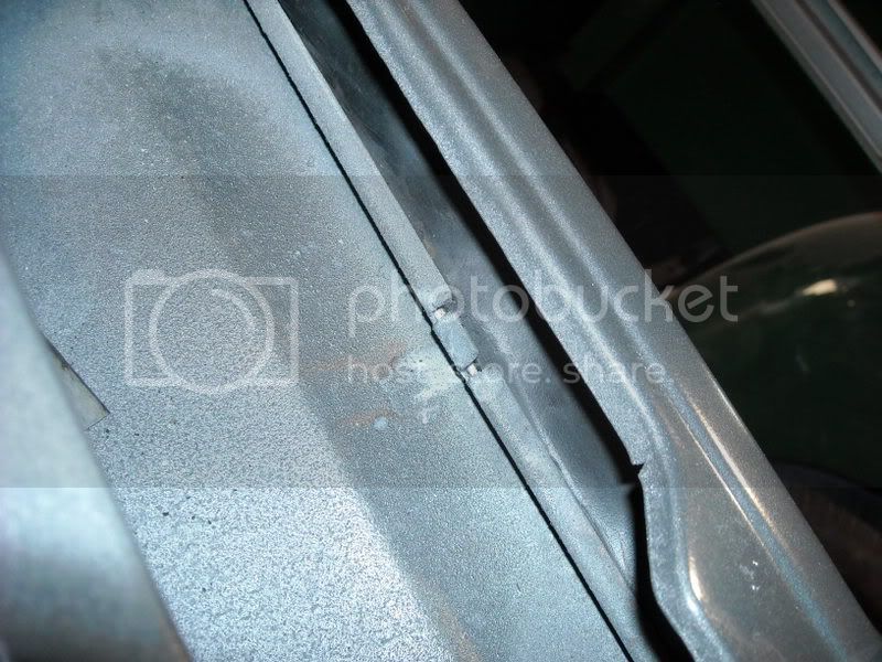

    Then the other..

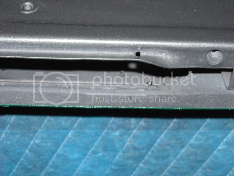

    And lock the tab by bending down.
