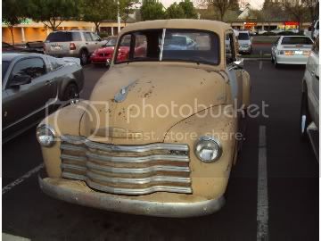

    Greetings All,
    1st time to this forum, glad I found it. I've spent some time here reading and learning. Lots of interesting questions. Thought I would
    share the story of my truck. Was given to me for a graduation (84) present by my dad. Drove the truck until 91. During that time, I put in a 327 with auto trans, lefted in the stock rear end, just welded the axle so it couldn't rotate, dropped in a center section from a 55 or 56 (don't remember year exactly)chevy truck cause it was a factory limited slip with 3.90's. Best time in the 1/4 mile was 14.28 at 98 mph in the 1/4 mile. Didn't like to stop real good with drum brakes on all four corners, but I was young and invincible.
    In 91, decide that I would rebuild it from the ground up. Took everything apart, fenders, glass, wiring, everything. Then life caught up with me. I got married, had a couple of kids, now I had to be responsible, put the truck on the way back burner. Tried to work on when I had extra money. I was talked into putting the front end (cross member)from a 76 chevy (the 76 is only 1 inch wider, weld 1/2 plates to outside of frame and bolt it up to frame). I got as far as rolling the front end under my truck, welding 1/2 plate to my frame and then changed my mind (such a terrible thing to lose when your young).
    So thats as far as I got on the truck until now. To the youngsters out there, life gets a little easier as you get older. Kids are older, I have more free time and a little more money. Truck has straight axle with disc brakes and a rack and pinion steering (no limit engineering), motor is at machine shop, have all the parts I need to compete the truck, down to even buying a compete bumper to bumper bolt kit, every nut and bolt I need. Just cut the firewall out last night. I'm want alittle more smooth firewall. Besides, after years of being drilled, screwed, and abused, the firewall needed to be replaced. I will post pictures here as I can, if that's ok.
    The extra parts, all the pieces that I have put on and taking off, and put on and takin off. The advise, life does get easier as you get older!
    Thanks for the time!

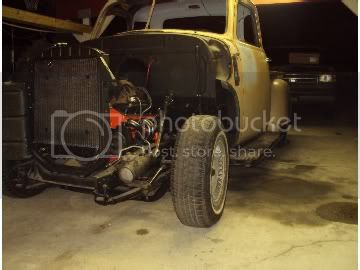

    Firewall is finished and it turned out better than I expected (first time welder and all). After welding, grinding and lots of sanding, I painted it with Rustoleum Satin Black and then covered it with 3M's "No Cleanup High Coverage Body Schutz" to give it alittle texture. To quote Brit "hey... it's my truck" so I can do it how ever I want.
    I also installed the rack and pinion steering. I was pretty amazed when I opened up the box of parts and found more pieces than I anticipated. It even came with a new steering shaft. The install was pretty straight forward. Here are a couple of pictures.

    steering rack
    BigMike,
    Looks good. The steering rack is the No Limit version correct? I like the thought of the rack and pinion for my lowered truck, to help with bump steer, but am running a 6 cylinder and may find it tough to install a pump. Any idea what the p/s rack originally came out of. I am wondering if there is a manual steering version of it. Also, was there special parts that came with the kit, such as mounting brackets etc.? Any clearance, or mounting problems with the rack that you ran into? Any help is appreciated. Thanks....Mike

    I bought the p/s rack from No Limit. It came as a kit, which included the rack, mounting bracket, tie rods, steering arms, steering shaft and joint. I don't think I'll have any clearance problems, but I'll know as soon as I drop in the engine. I do not know what the rack came out of, If I ever need another one, I'll have to contact them.
    You should be able to run a p/s pump on your 6. If you can't find brackets, why not make them?

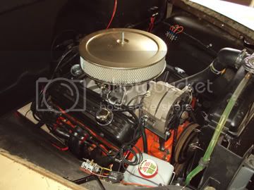

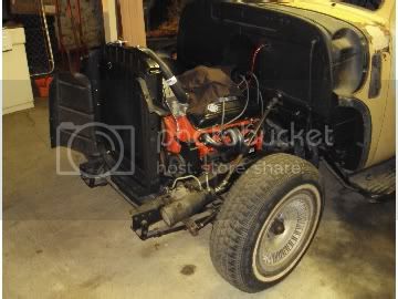

    Hello All,
    Hard to believe it's been 4 years since I've posted anything about my truck. Life has a way of kicking your tail! Between work, kids, work and being there for the wife as she beats breast cancer, it's been a challenge! I know it's by no means a show stopper, but it is the way I like it. Since 06, I've lowered it 4 inches with a front axle from sid's dropped axles and blocks in the rear. It's got a seat out of a 90's chevy truck. A rear end out of a 89 firebird, a sbc 283, a rear gas tank out of a 74 suburban, a ididit tilt steering column, power steering box from a 76 chevy truck, and a ezwiring wire harness. I've got to have it driveable by the first of March. I'm taking the wife to Vegas for VLV 2011 in April and I want to make sure I have a few miles on it before I head out to Vegas. It's my wife's b-day the same weekend as VLV 2011 so it's kind of a road trip for her and I. I'll do the body work and paint later in the year. It's been sitting so long I just want to drive it! Here's some advise.... JUST DRIVE IT!
    [​IMG] [​IMG]
    [​IMG] [​IMG]
    Big Mike

    Hello All,
    Just an update on where we sit today. But first I want to send a special Thank You to Ol' Chebby. Your "How to assemble a AD" was instramental in the assembly of my truck. When my son and I installed the glass, I studied your thread, and got it done. Thank You!
    SWMBO and I are driving the truck to Las Vegas on Thursday for the VLV 2011.

    Any behind the front end R&P unit will work, the ones front mounted will steer backwards. A favorite because of it's compact nature is a VW unit. All those we have used have been manual but steer easy with normal size tires. How much travel is in the steering shaft slip joint? Was going to use just the main leaf on a front spring so I could raise and lower the axle through it's entire travel to check the length of slip joint needed. Not a thing wrong with the firewall approach and 3M Shutz is paintable.
  18. bigmikes50chevy
    bigmikes50chevy Member
    Jun 22, 2006
    64
    Fresno
    I'm really not sure how much travel the slip joint has (and I assume your talking about the steering). It was the original slip joint that came with the rack and pinion steering I bought. I had to cut it down to try and make it fit with the sbc, but there was no way with where my headers are. You can see in one of the pics, the steering shaft goes towards the left front. With the rack and pinion, it went straight through #7 header tube. There is good movement in the slip joint. I don't think I'll have a problem with it.
    I do like the 3M Shutz. It was easy to apply and painted with no problem. I would recommend it to anyone.
    Coilover... arent't you the one that mentioned something about how to install a keyed lock on the drivers door some time back? My memory isn't what it used to be :eek:.
    BigMike

    Hey Mike,
    I c in your pictures that u used a catch can with your original radiator.... does the fan help that out? (pukeing)
    What type of steering column and wheel did u use?
    Thanx !
