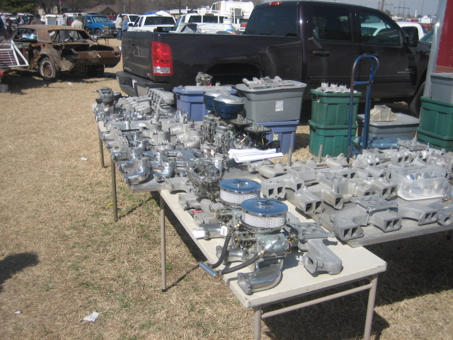

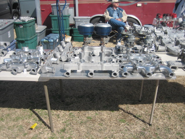

    I used the 54 Corvette 235 dual exhaust. Almost extinct now. If you get stuck on some problem let me know and I will put you in contact with an expert on multi carb intakes for six cylinder engines. First picture is an overall view of his swap meet display and second pic shows two tables of 235 intakes. He has many times more than this at home.

    Wow this salesman has a lot of good intakes on the table( wonderland ) I am going for the Fenton dual intake solution , ordered it from Patricks yesterday. I need a cople of good remanufactured carbs with the 2-15/16 senterline distance. Could you be kind to send me a pm. with the adres and phonenumber of the expert ?
    Maybe he has some good carbs he wants to sell me ?
