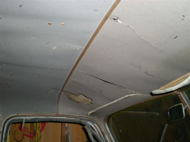

    I bought a headliner for mine that was too short all around. I called the vendor and they sent me another one (which, by the way, was worse). Long story short, I bought material and cut one using the others as a template. The middle bow is a floating bow that basically holds both pieces together and tucks under the weatherstriping. They say a picture is worth a thousand words, so...

    You're right, a picture is worth a thousand words, and two pictures are worth two thousand words. How about three or four thousand words. I think I understand a lot more with the one picture but a few more might shed a lot more light.
  5. Kens 50 PU
    Here's 2000 more words!
    Here's a couple of shots of Thunder54's headliner.

    Guys - I liked Russ' recommendation about duct taping across the center bar...however, my '48 mid support is not "floating", as I attempt to show in the attached photos. The '48 door opening weatherstrip details appear to be different than Ken's 50 as well. Larry
  8. Kens 50 PU
    Don't quote me on this, but I think that the floating support came out in the late '49 models and carried through to the end of the AD series. Prior to that, the middle support screwed in.
