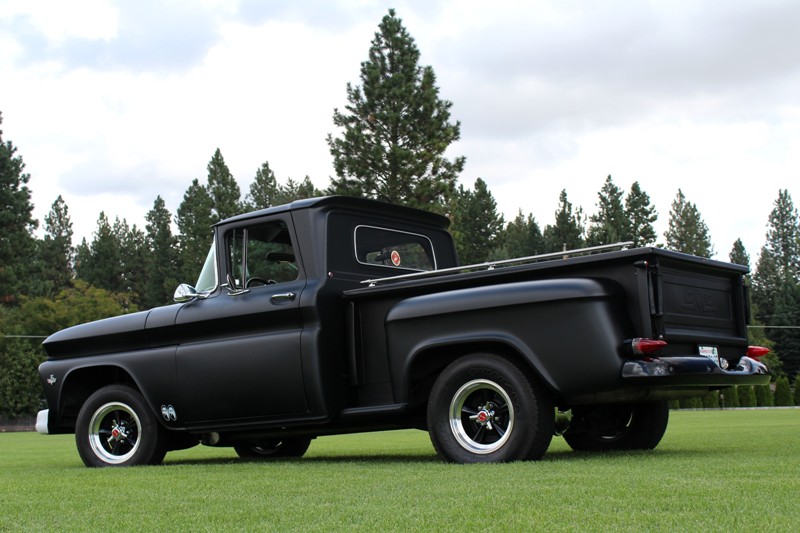

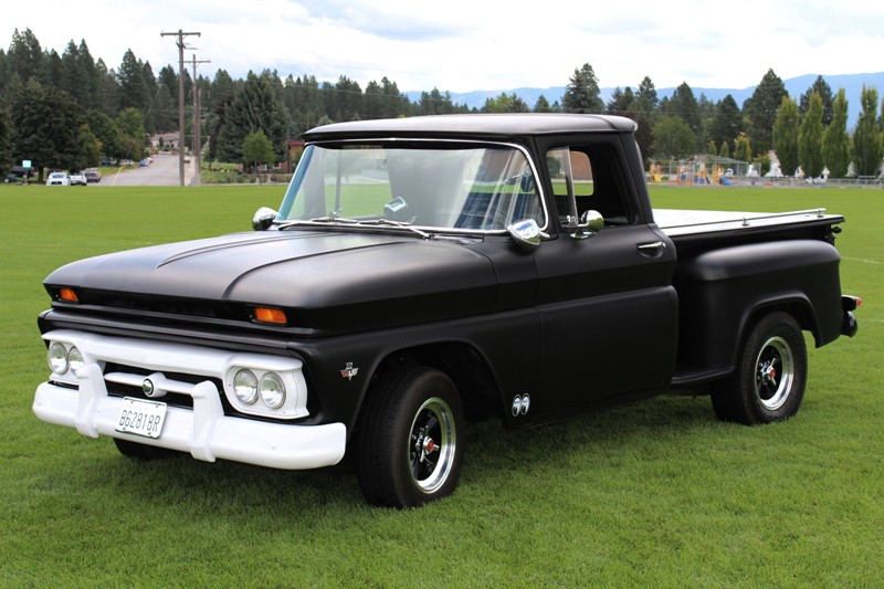

    Mine is 17 inches on both sides. Back in 1997 I installed 1 inch lowering springs in front, but over time the drivers side sagged an extra inch. I installed a 1 inch spring rubber on that side to bring it back to level. It looks even higher in the front than it is because my front tires are just under 27 inches tall when new. The tire/fender gap also increased some when I removed the inner fenders. All things considered I think mine rides pretty close to stock height:
    Because the rear tires are just over 29" tall when new, it still has a pretty good nose down rubber rake. It doesn't sit level as it appears in the first photo:
