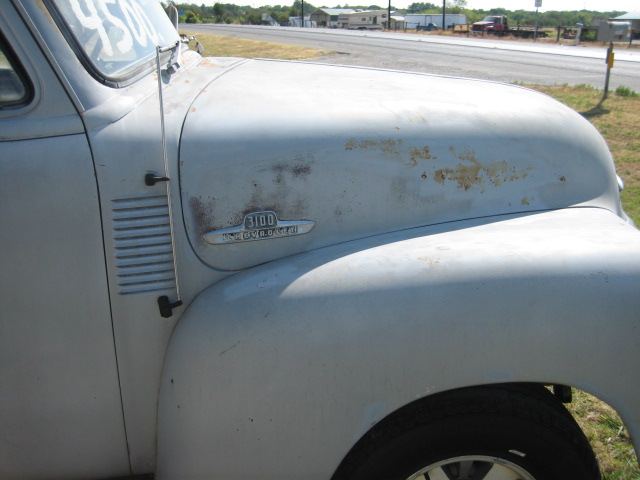

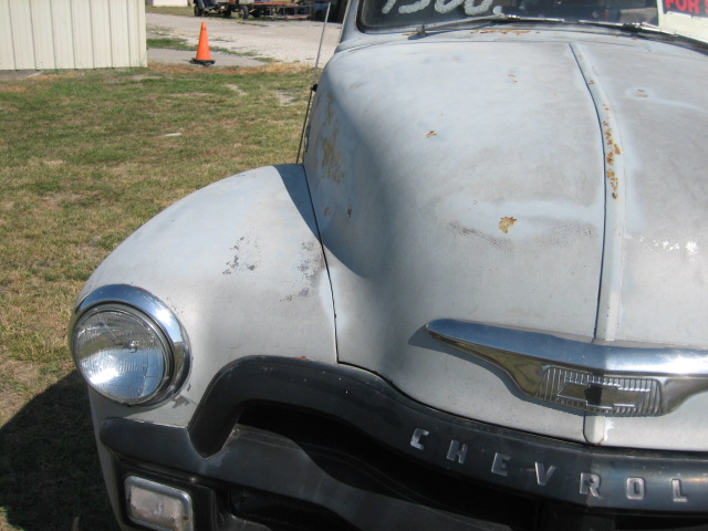

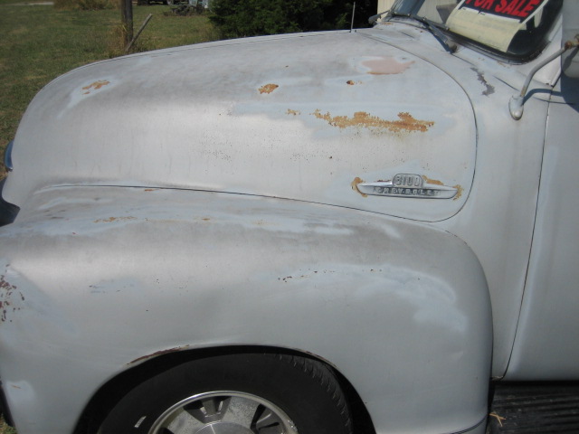

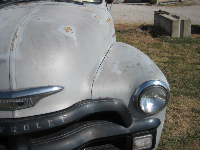

    The very first thing we do is toss the hinges. We fit the hood/fenders/firewall gaps and THEN fiddle with the hinges. You have too many things going on to try and make everything fit at once. This is always done before the truck is painted but the pieces are "cut in" before bolting together so everything is painted when finished. Here's a recent 54 that came through the shop.

    Thanks for the advice and the great pics. I know I've seen these trucks with good lines or at least not a 3/4 " gap. Gonna take off the hinges and give it a try.
