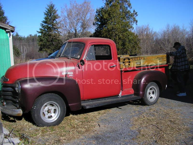

  8. omega7979
    omega7979 Member
    Jan 20, 2006
    75
    chicopee Massachusetts
    here is a pic of my truck when I picked it up at my aunts farm in upstate new york.........
    thanks for the help figuring out the pic upload...
  9. vwnate1
    11,675
    Nice truck !
    Remember to use only GAS charged shocks and the stiffest ones you can get at that so you'll not be bottoming out al the time ~ these trucks are _HEAVY_
    compared to to-day's and the gas shocks will make a noticable differance in ride improvement .
    Keep up the good work , Diamond Springs are good too .

    Omega:
    Just noticed the 5 lug wheels fore and aft. You MAY still have a stock front end as 5 jug Chevy car hubs from around 53/54 are interchangable with our 6 lug hubs or someone may have made more extensive modifications to the front.
    I'll bet the stock rear end has been replaced with something newer.
  11. omega7979
    omega7979 Member
    Jan 20, 2006
    75
    Yes the truck has 5 lug wheels.......i'm thinkin you are correct about the chevy car hubs because its original looking drum brakes with the ball bearings and all.........as far as the rear end goes.....someone hacked out the old one and welded in a entire assembly out of a late 70's nova.......they did a butcher job but atleast they didnt go chopping up the frame......I can remove the junk they put on just by grinding it off.....I have in my posession now a rear end out of a 72 camaro....the 8 1/2 ring gear one which will hold up well.
