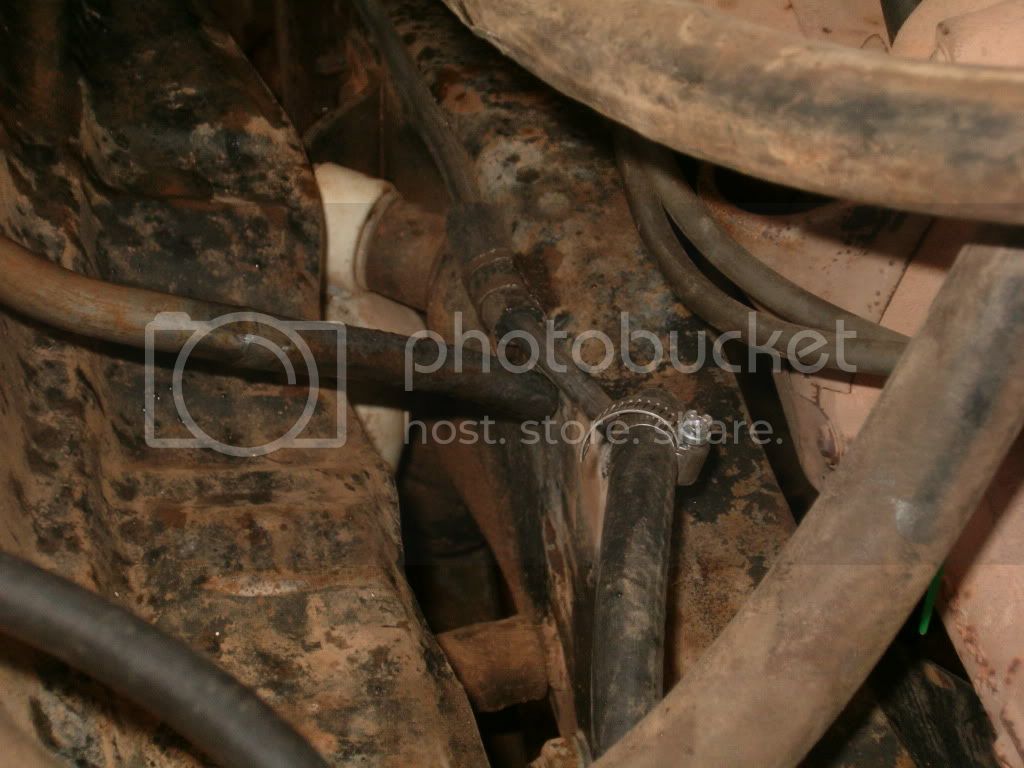

    As I posted earlier This thing makes me wounder if it was a diesel at one time
    check out the fuel line. the installed line is actually a trans cooling line the line next to it, at a 90 degree. is the original line
