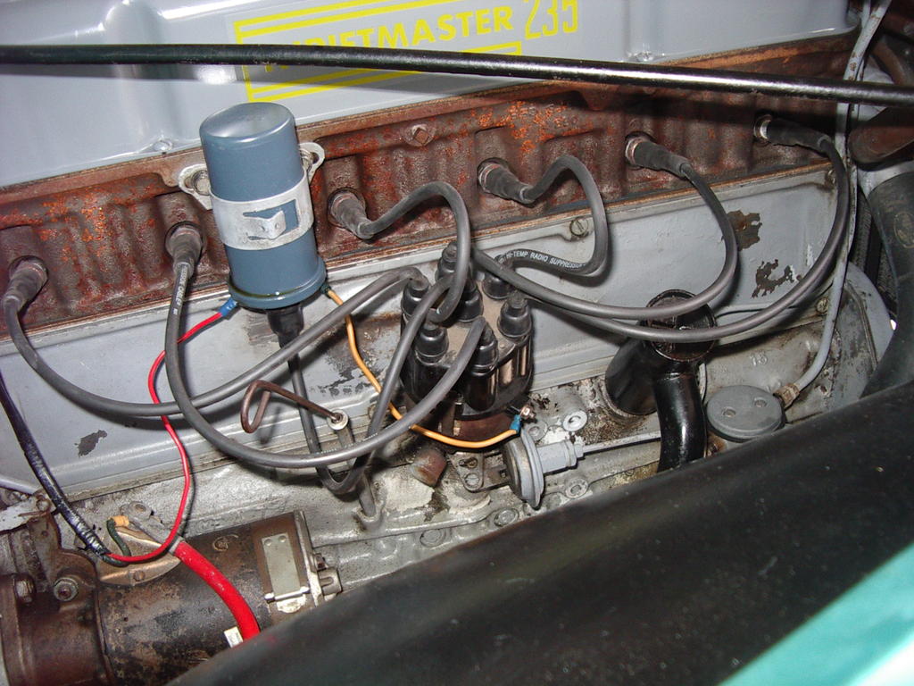

  10. JW 54
    JW 54 Member
    Nov 12, 2009
    113
    Cypress Texas
    Wires Crossed?
    Could this be the problem? These wires Don't appear to be in the correct order. Could someone confirm this. Possibly send me a picture of the correct order? I had a guy do a compression check & it appears as though he put the wires back on wrong.
    Thanks, JW
  11. JW 54
    JW 54 Member
    Nov 12, 2009
    113
    Cypress Texas
    Crossed Wires
    My #3 and #4 spark plug wires were reversed. Switched them, test drove, now runs smooth as butter. Don't know why this would affect the fuel system but runs great now. Maybe two different problems. Thanks for everyones help. This is a great forum for advice.
    JW
  12. vwnate1
    Plug Wires & Firing Order
    This is an easy one to remember , think about Women :
    15 is TOO YOUNG
    36 is TOO OLD
    24 is JUST RIGHT
    :rolleyes:
    :p
    BTW : you neglected to say " immediately after I fiddled with the ignition system it began to choke and sputter " , that's why no one figured it out ~ you left out important information .
