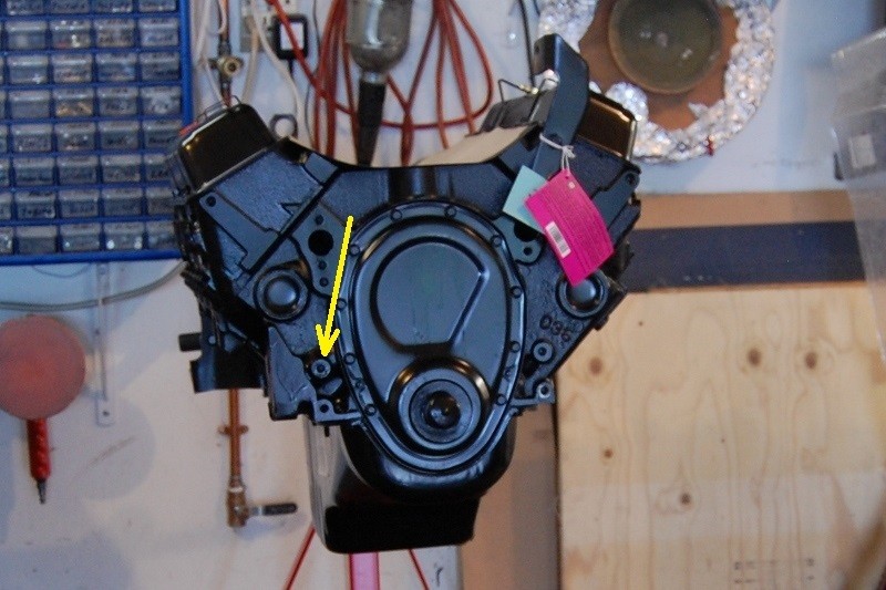

    If you have an original small block V8 engine, the best tip I can offer is to remove the upper bolt on the front of the engine that was originally designed for the 1955 front motor mounts. Here?s a shot of what I?m talking about:
    Install a longer bolt, but only pull it up hand tight, as it will bump into the push rod running between the fuel pump lever and the camshaft. This will hold the push rod up, while you remove and replace the pump. Once the new pump is in place, remove the long bolt holding the push rod up, and replace it with the original.
    If the push rod is not held out of the way, it will slide down and cause fits to try and get it back in place. Also, this will only work with original engines. New crate motors no longer have this hole drilled and tapped all the way through.
