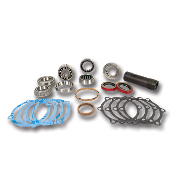

    As i can remember its an 1953 truck you have .You can either buy a complete seal/gasket kit or seperate parts for your rear end at Classic Parts. Remember to use some sealant on both sides of your gasket . I have very good experiences in using Permatex ultra copper sealant or PERMATEX ULTRA GREY RTV SILICONE from the Permatex series . It is a bit moore expensive then other sealants but it has amazing strech and heating tolerance.
