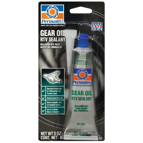

    Permatex makes an RTV specifically for gear oil. It's works quite well. Just used some last weekend.
    Hope that helps.
