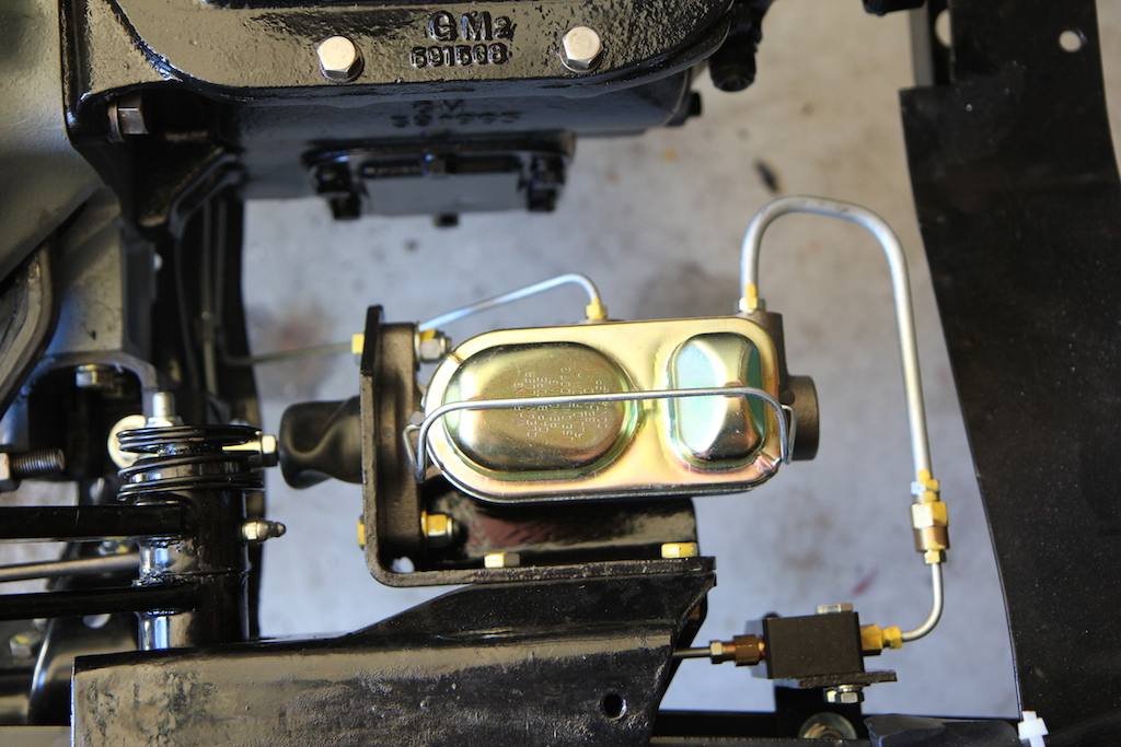

I went the dual master cylinder route with a brake proportioning valve, see lower right corner of picture. Haasman
