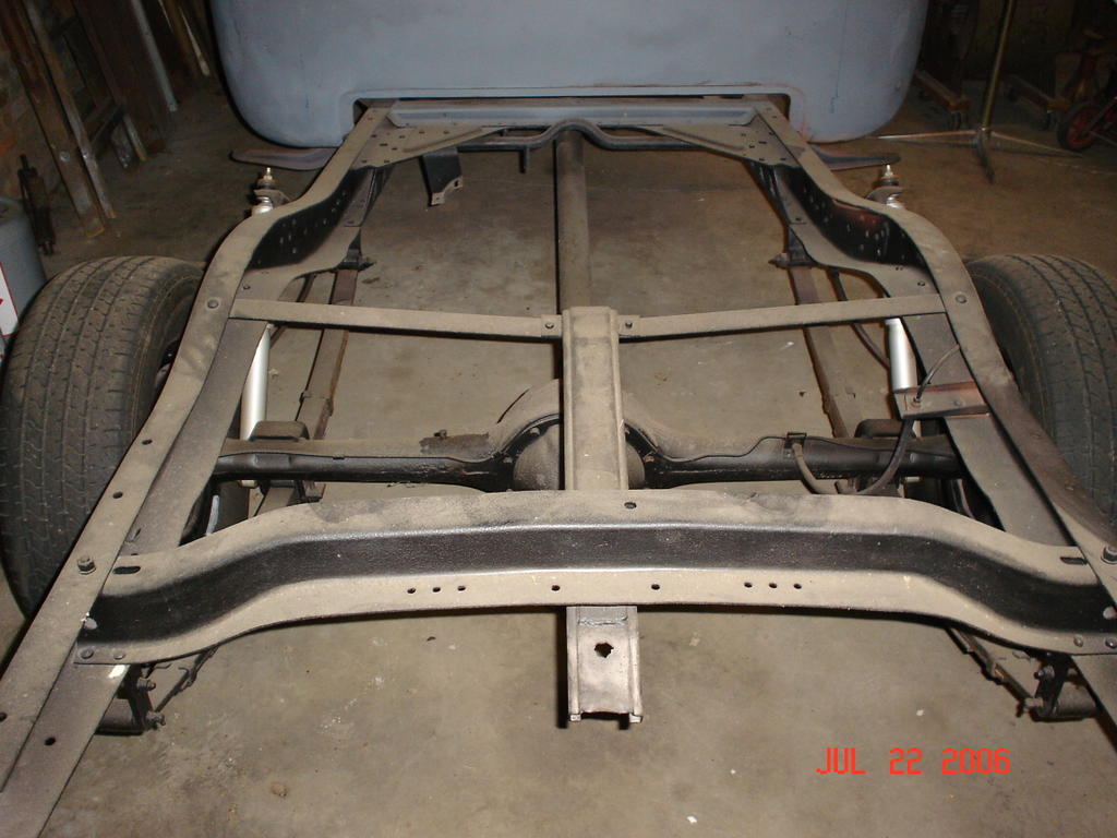

    I'm at a loss as to exactly how my spare tire carrier works. I can visualize most of it except for where the hook attaches at the top.
    [/ATTACH]

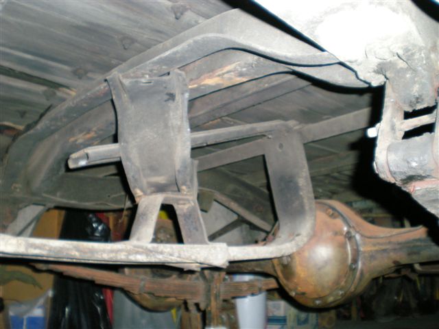

    The attached pictures show the back end of the truck and the spare tire carrier. Where does the hook attach?
    Thanks in advance,
    Ken

    Ken ;
    That's a funny looking one ~ maybe for 8 lug wheels ? :confused:
    Anyways , the usual ones are mounted at a 45° angle with the inner end on the left ,mouting stud goes into the left frame rail and there's a hole for it .
    Right side gets the rearward end and the J hook (IIRC) holds the front end of it and you need another , different bolt to hold the rear end of it , as there's a funny looking nut that screws up onto it , passing through a key hole shaped hole I don't see in your picture .
    If you go to the home page and look in the flies of photos , there's a diagram of two different typs of underbed carrier , the sliding typ (pre '51) and the cross typ , different but similar to the one you have there... maybe you can print out the diagram and crawl under the frame and figure it out ? or look in the '53 owner's manual or the assembly manual ~ I'm @ SWMBO's house so all my books are far away right now , sorry buddy .

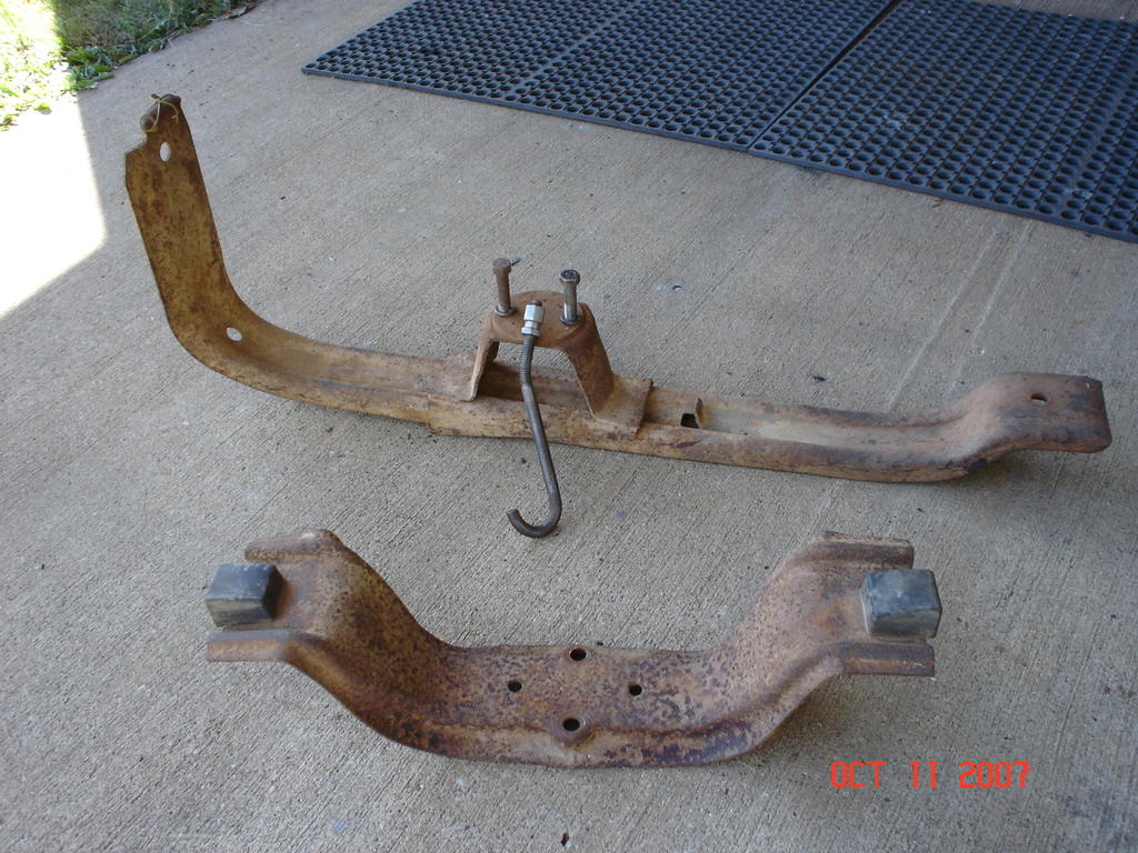

    A picture is worth?
    Ken - I hope this helps...Larry

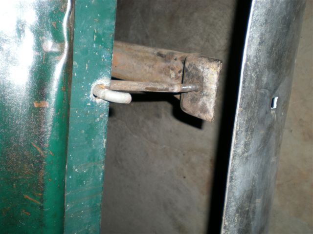

    Bad Angle on earlier pic
    Nate, it's the original carrier that came on the truck.
    Larry, thanks a million for the pic. It all came together when I saw your setup.
    Here's a shot of mine at a different angle.

  6. Kens 50 PU
    Just for you rons50
    This should make it clear as mud.;)

    thanks for the pics and info
    this makes it clear guys thank you
