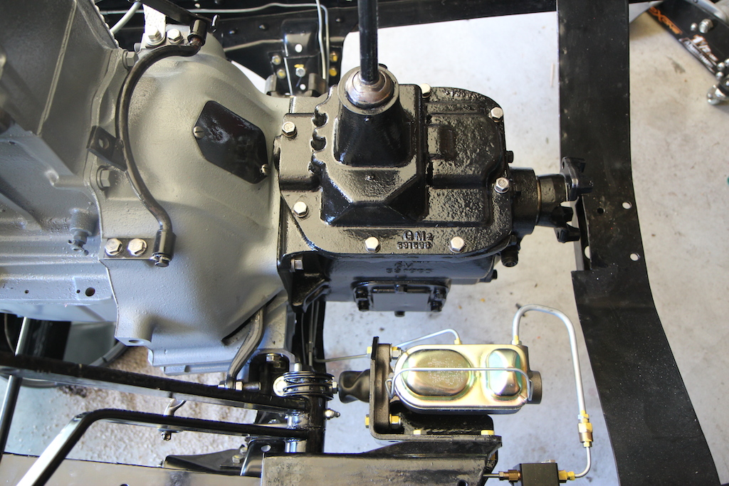

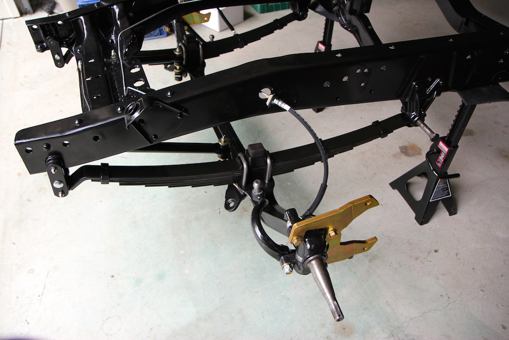

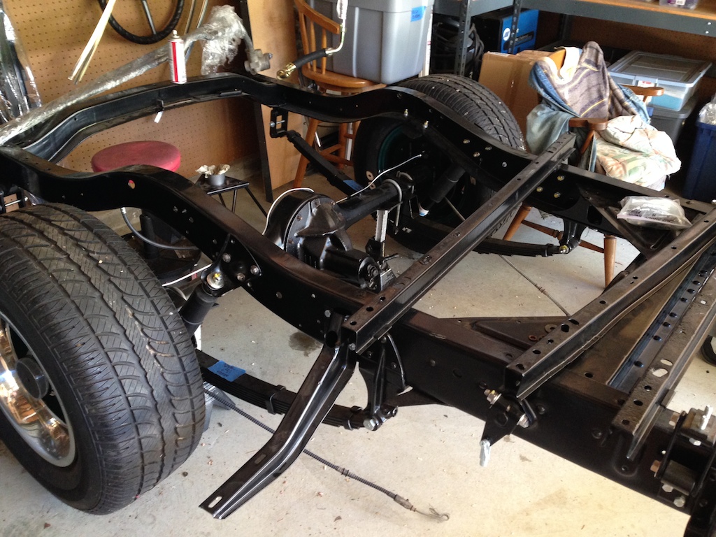

    I've been asked to post some pictures of my truck. I should point out I have never done anything like this before. I now have the time to work on it and I wanted to do a really good job.
    OK, I had no idea what I was getting into. I bought the truck being told it was "somewhat restored" ..... OK..... It wasn't.
    First date night in the truck coming back from dinner the headlights went out around a curve! That's when I found out the wiring insulation being 60 years old was dust, literally! Coming down a long steep hill near where I live I found out that 60 year old brakes can't compete with modern disk brakes. I had to pull into the emergency lane when traffic came to a sudden stop ahead. I finally came to a full stop 6 car lengths past. Wow, OK install front disks.
    My concept is to keep it basically stock with a few modern improvements. I want to drive it regularly. I took it down to the frame, had a friend who is a sand blaster and a powder coater do the frame and a lot of parts. Our agreement was I would come hang out and he'd powder coat for a reasonable price.
    I have learned a ton about drilling out broken bolts, basically how not to do things and also spent some good time with my son, which has been great
    So here are some pictures of my project so far. I don't do paint and body work, but I marvel at those that do. I am currently awaiting my cab to be finished painted so I can start putting all those parts back together again.
    Because of the patience, generosity and support from this site I am able to overcome some problems and figure out how my Advanced Design goes back together.
    I'll post some more pictures as I make progress. (If I can do this, you can do this!)

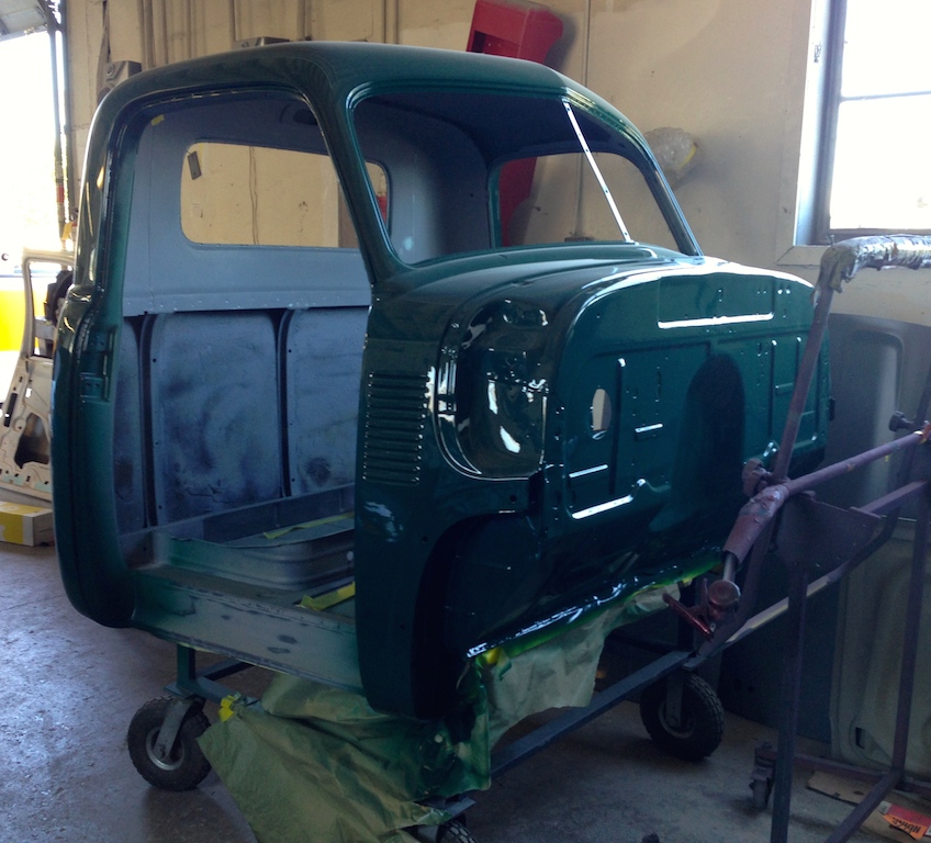

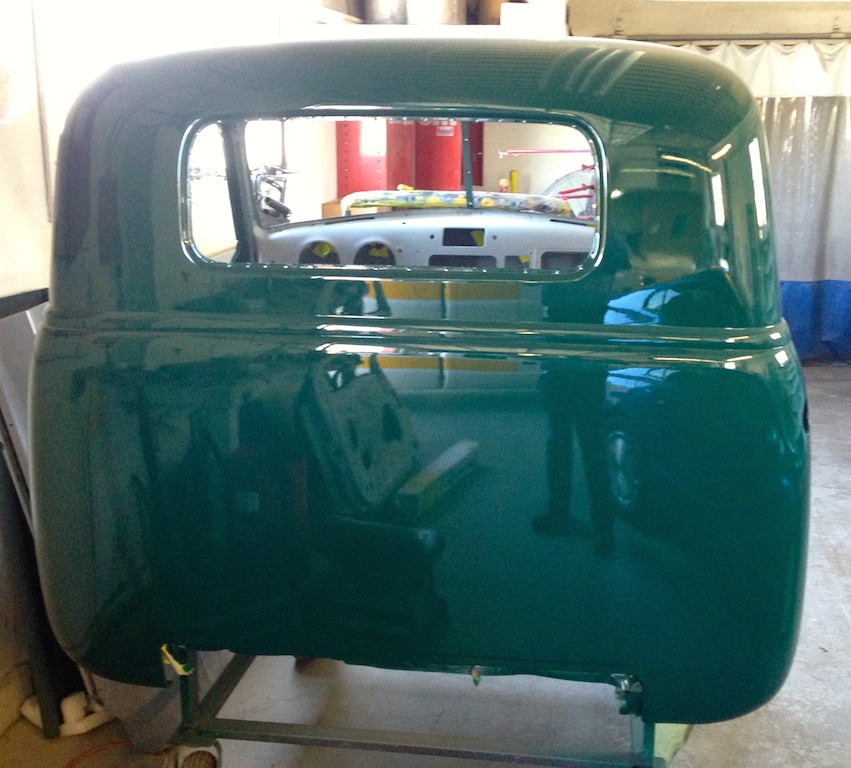

    It is being painted a dark green, the same color before I tore it all down.
    Here is the cab in the paint shop-

  8. 50 Chevy LS3
    50 Chevy LS3 Member
    Jan 14, 2013
    951
    Indiana
    Very nice!
    Interesting dropped springs, I've never seen any like those. Where did you get them?

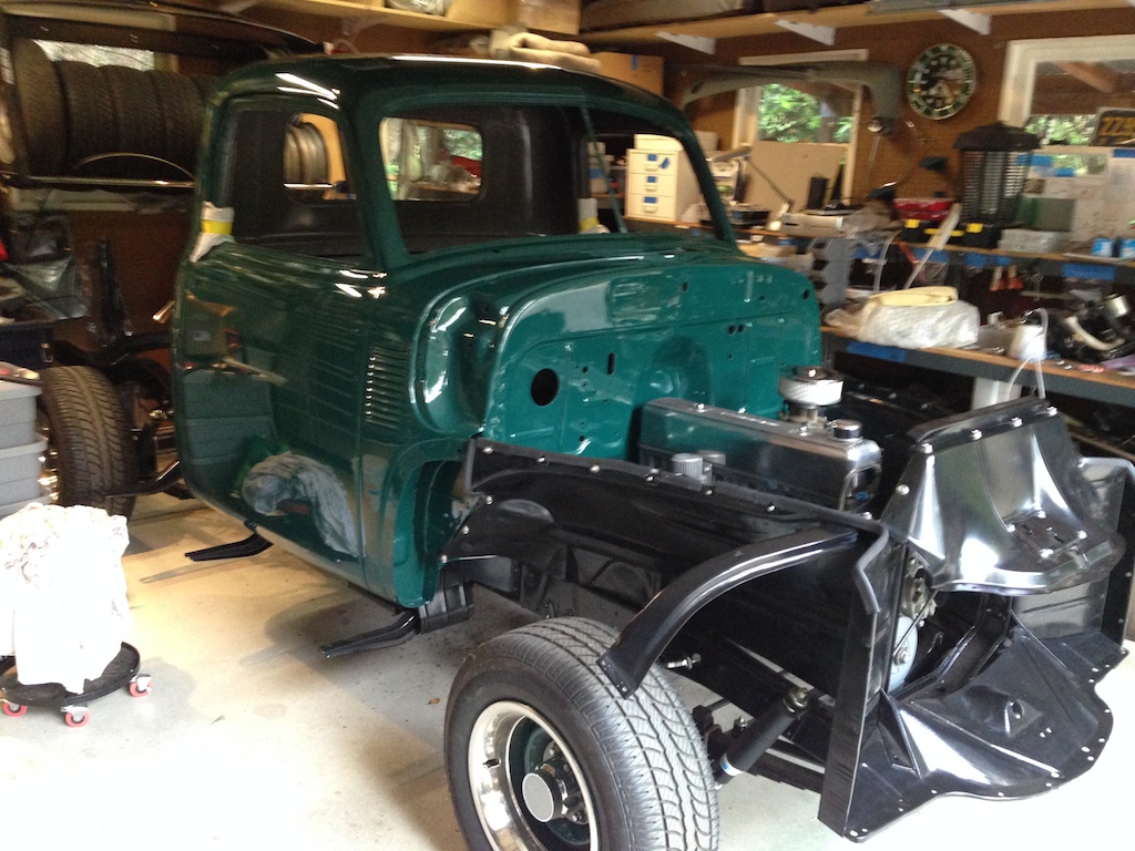

    The good news is I got the cab back from the painter and installed it this weekend on the chassis! I can't begin to describe how good feeling this is. Really marks a change in progress. Now everything I am doing is building, not repairing or cleaning. Waited a long time for the phase of the restoration.
    Several things I really am glad I did-
    -Ziplock bags (freezer ones because they are tougher) that I put everything I took off into. I had several boxes and black sharpies around the garage, constantly popping different nuts, washers, fasteners into them and labeling like a mad man. NOW, when I am unsure about how a particular part, piece or section goes together, I look for the bag with the parts in it. Incredibly helpful.
    -Although it may seem extravagant, I purchase stainless fastener kit for this truck. Yes, stainless is cool (being careful to use some sort of lube like anti-sieze so they don't gall when tightening) but they send you little bags with labels saying for an example "front fenders" or "hood hinges' etc. Very helpful when trying to figure out what bolt goes where. (I dismantled this truck almost two years ago!)

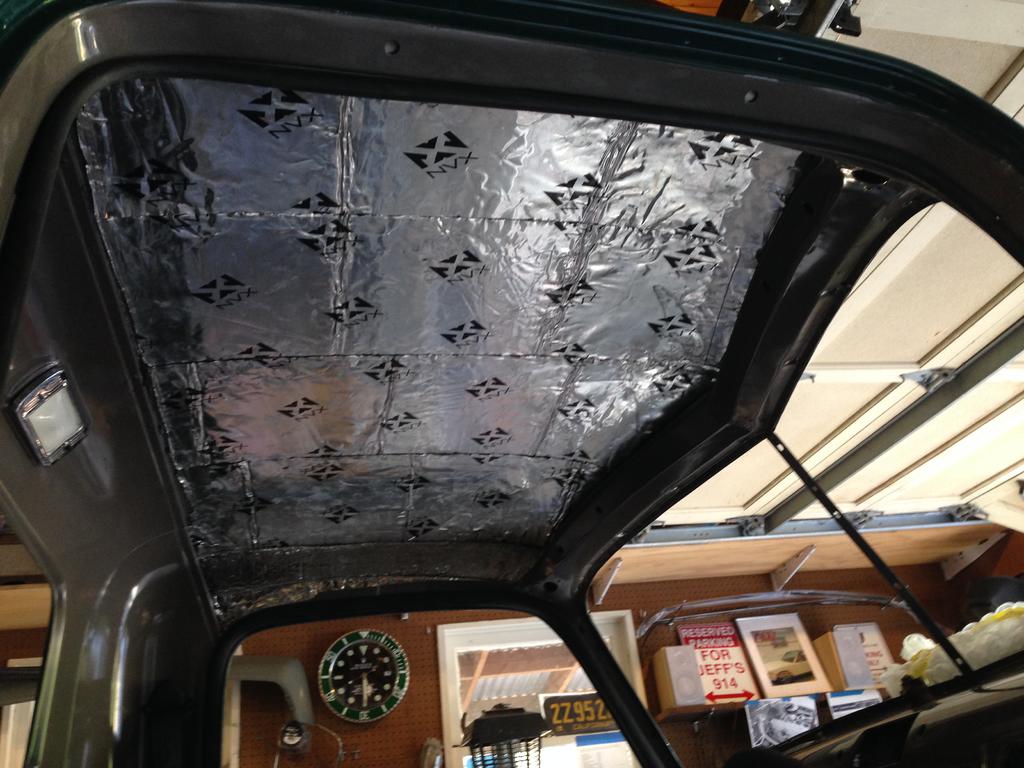

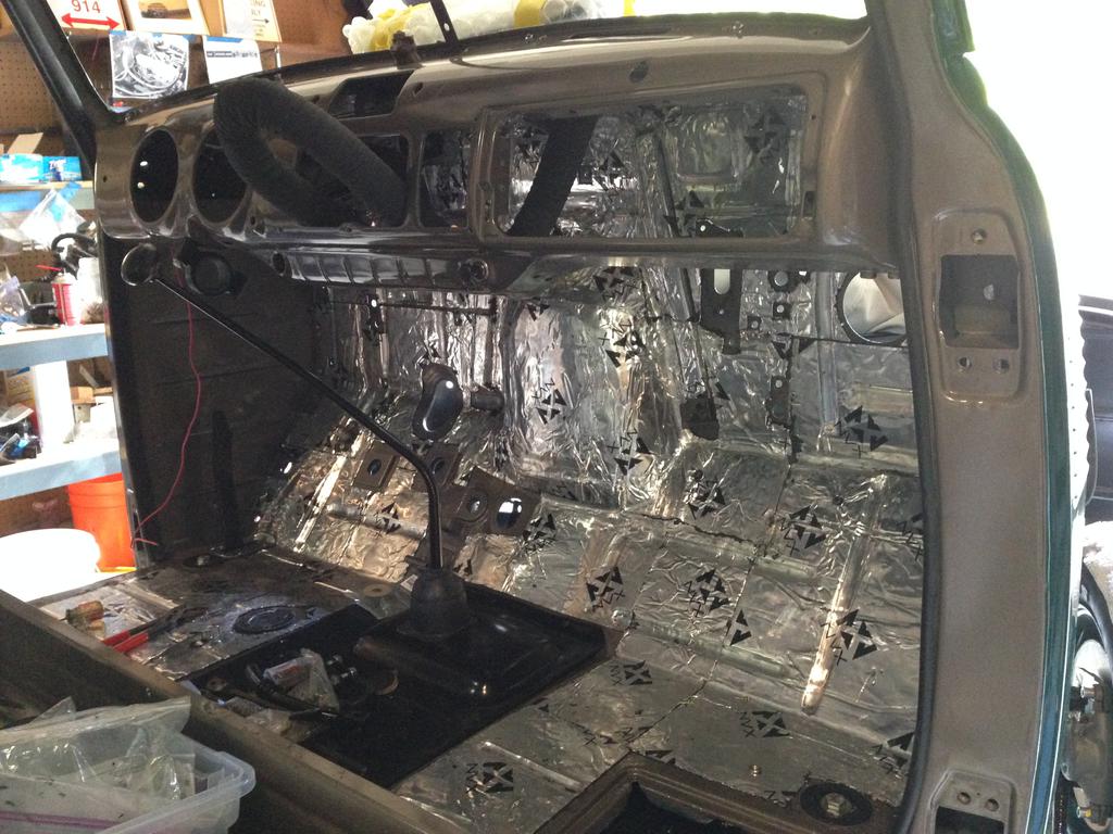

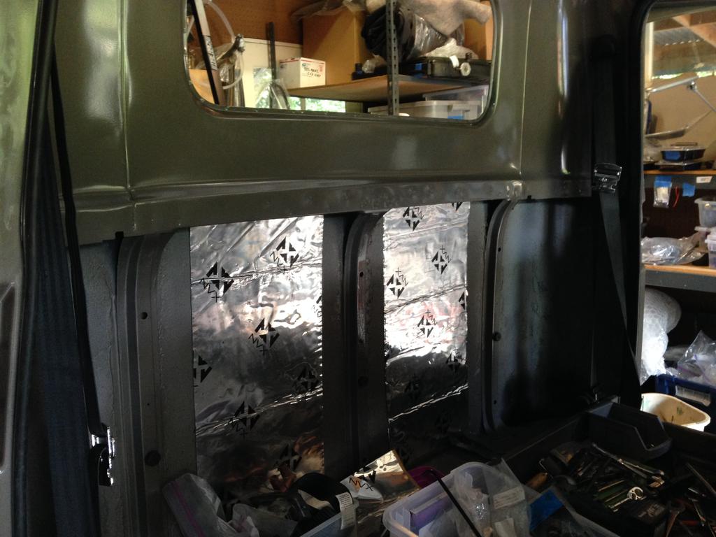

    Haven't updated in a while. Have spend a lot of time working on the firewall area. I rolled some economical sound mat all over the firewall. I then installed padded vinyl cover, held in with bolts and large washers instead of the OEM clips. I am tying to seal the firewall as much as possible.
    You don't have to cover all of the panel. The effect is great. Tap on the roof and now it is a dull thud, instead of a kind of "tang" sound.
