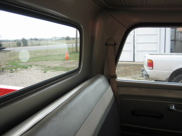

    Is your truck one with the small back glass? If it is then you could do what we did for a 3 point shoulder strap type belt only extend the anchor plate far enough for another mount point. We cut a strip out of the outer skin and formed a 1/4" x 4" plate to fit behind the inside skin and weld to the rear window opening and the door pillar. On the custom cab the "Custom" trim on the rear pillar hides most of the welds where the cut out strip is reinstalled. I know it's stronger than the human body so anymore strength than that is over kill. I think someone is offering a kit for this now.
