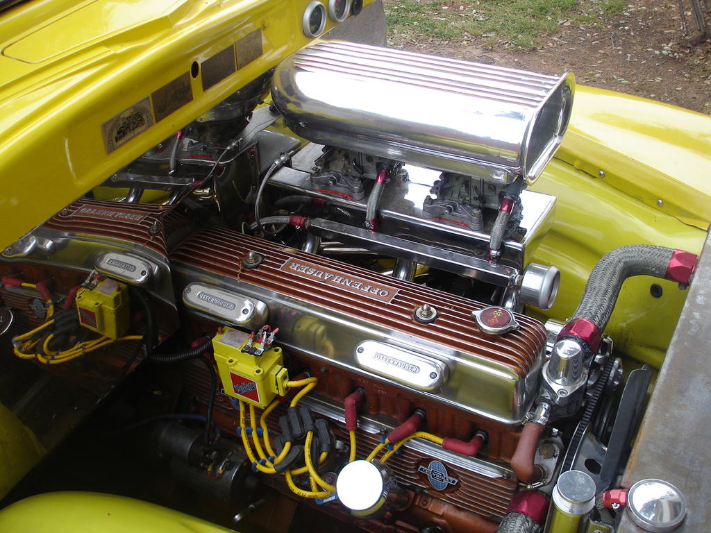

    Soooooo is .120 off the head and .008 off the block with recessed valves and 9.5:1 pistons a little tooooo much or could it be just the beginning?...lol tims pics 025.jpg

    Increased compression.
    No problem with the new spesifications. These engines have an enourmes tolerance for production of more power . Did you polished your cam or does it have an racing cam that makes it stonger ? Turbo charged 6 inline is posseble to. Considdered that ?
    2 in oversized pistons , valved shape or normal centric ?

    It has a Crower cam Split lift/split duration, custom made 4 bolt main caps I beam ground/shot peend rods with Arp rod bolts. The center weight was cut off the crank and the crank was balanced, the rods were weighed and it has a Aluminum fly wheel. The head was also ported and the valves were given a 3 angle grind. I use a Super T10 Borg Warner 4Spd along with a narrowed 9In. with 456 gears and a locker. The rear tires are 31x18.50x15 Mickeys, It will do 102 MPH at 5000 RPMs. I usually shift out of 1St and 2Nd at 6000 RPMs. I'm gonna be pulling it out of storage pretty soon and taking it to the new house where I'm gonna be finishing it up, I think that after 35 years it's about time....

    We need pictures!
