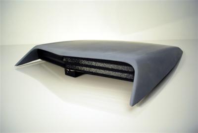

Air Extraction Hood If you have multiple threads about the same topic, maybe you could merge all the data here? Makes it much easier for us to help answer your queries. Air Extraction Hood Modern Corvettes, Camaro's and Mustangs have heat extractor hoods that release hot air from the engine compartment to provide extra cooling. Basically they have a recessed area with openings that create a low air pressure area that pulls heat out of the engine bay. On the new Z/28 this also provides considerable down force too. Maybe adapt one of these hood center section to your classic pickup? More discussion here courtesy Camaro5: Best Hood/Hood Modification For Heat Extraction Thanks, John

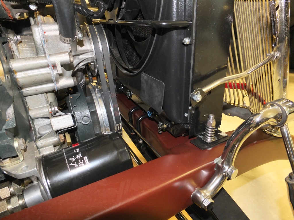

Wow.. what a beautiful truck you have... simply stunning. After looking at your photos a couple things come to mind. Cutting holes in the cowl? I'd hold off on that for now. The holes in the shroud beside the radiator?. plug those, same thing with the holes in the sheet above the radiator. You want all the air that comes through the grill to go through the radiator. It appears your radiator shroud is flat on the back of the radiator? How much space is there between the shroud and the radiator fins? Most shrouds are conical shape to allow the air to come through the radiator and then not restrict it as it moves toward the center and out through the opening at the fan. Often the shroud will also have a couple small openings that have rubber flaps on the back of it (see photos below). This allows air to exit when you are at highway speeds, but they close at slower speeds so the fan can pull the air through the radiator.
