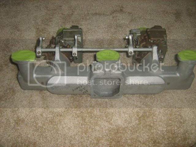

    I have a D & S Dual intake for my Blue Flame and and I'm using it with a set of Fenton Headers.
    I've seen that you can buy a heat shield at Langdon's so you can run the radiator water through it, or put in steel tubing between the headers and the intake.
    My question is why do you want to heat up the intake, don't you want to keep the intake cool? Or am I a complete moron?
    And - If I do want to heat it up, what is the best way to go? Exhaust heat or water heat?
    Please help me out
    Klaus
