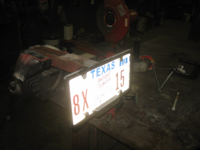

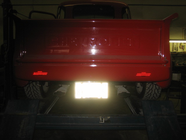

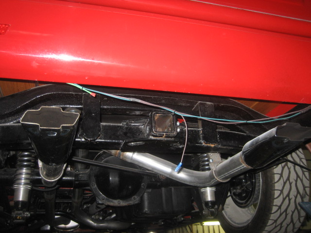

    Here's one we put on a 48 with a roll pan. There is a plate welded onto one end of a square tube that fits into the receiver. The license plate frame has light incorporated into it and a quick disconnect. The receiver is bolted to the frame rails and has two extra braces bolted to the spare tire cross member.
