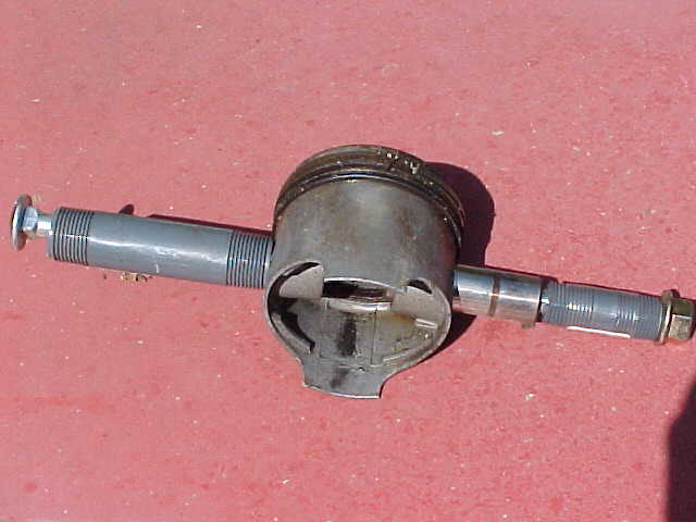

    O.K. sorry this took so long . I've been baby sitting my son after his inury .
    Lessee if I can attach the picture i have on a floppy disc .
    Here we go ! :D

    I like it. Looks like it works dandy.

    Very creative, Nate! That looks like one of those, "You're not gonna screw me" kinda things! Thank God for part stores, huh?:cool:

    ...That one was made up in a hurry using sprinkler risors and a bolt I'd bought to re-anchor my garage door spring .
    I used it to press some Gudgeon Pins (ask Niel) out , for spring eye bushings I'd replace the PVC bits with steel pipes .
    It really does work a treat ! ;)

    Naw , just use a big ol' C - clamp instead ~ thataway you needn't drill a hole through it 1st. :D

    Ask me about gudgeon pins???? Nate, not sure what you mean but for removing them i prefer the old tried and tested clamping the piston tight in a vice (metal jaw) and hammering them out with a sharp chisel and a 2lb lump hammer, with a touch of grinding paste for good luck.
