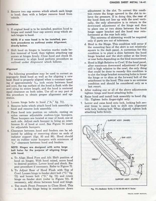

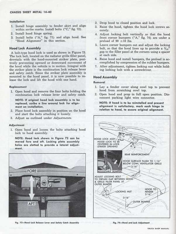

    Perhaps these hood alignment instructions from the 1960 Chevy Truck shop manual will help. The actual adjustments are indicated on the 3rd page, but the 1st two have pictures that are referenced along with other information that may be helpful.
