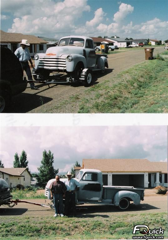

    Here is what my truck looked like before moving my fenders forward.
    This was the day we picked up the empty shell of a truck. ( I'm in the hat)
