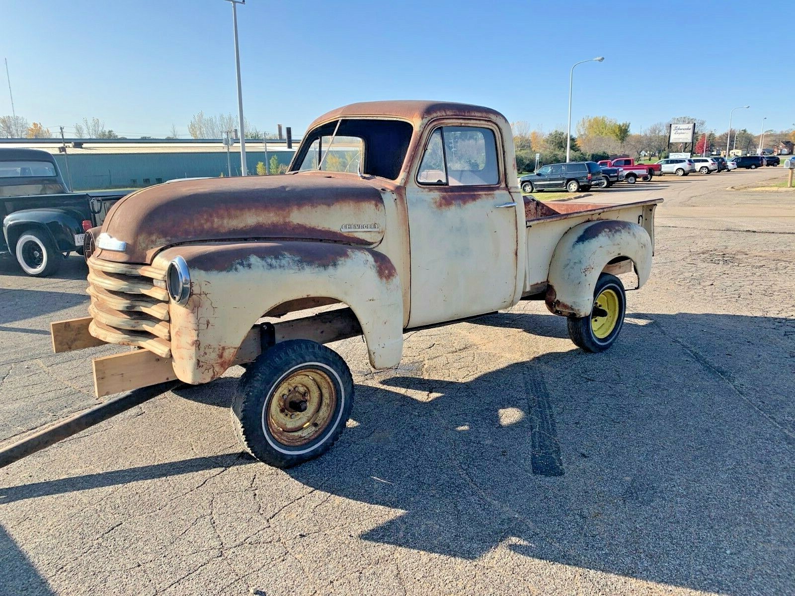

  7. Bill Hanlon
    2,498
    Klein TX
    Like this?
