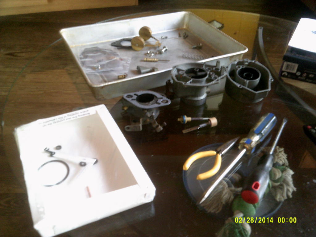

    Indeed, I blew the line out as well. Actually, I replaced everything as far as the line goes a few years back.
    I came across an obvious problem I couldn't have noticed unless I was holding the carb in my hand.
    The gasket I got for the base of the carb had no cutout for the vacuum port on the bottom of the carb's flange. IE, no vacuum for those carb parts that need it~
    Anywho, I have a carburetor rebuild kit showing up at NAPA tomorrow, so you know how I will be spending most of my day tomorrow.

  17. Zig
    Pictures?
    Carb was rebuilt last week. It was a cool/fun thing to do!
    The kit had the wrong plunger for my carb, but Napa got me the one that I needed.
