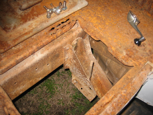

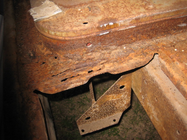

    No bottom on this box as it is being replaced but does show frame brackets. First picture shows the splash shield just in front of the bracket and shows the bracket is almost touching the front running board brace. Yours must have been replaced previously because they are riveted on from the factory.
