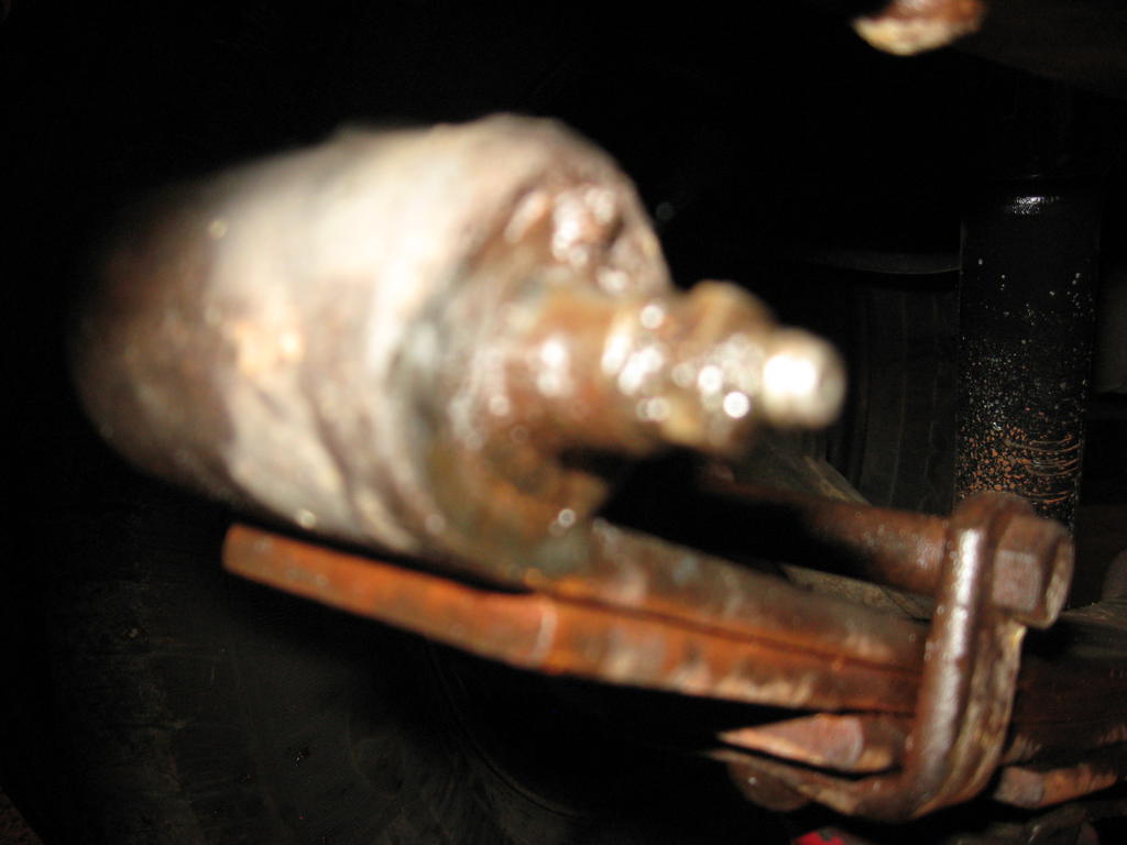

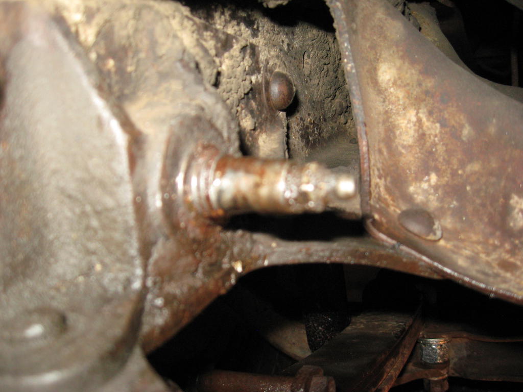

    Spring Eye Bushings
    IIRC (it depends on the year) , the pin in the spring unscrews then you use some sockets and All Thread to press the old worn out bushing out of the spring eye .
