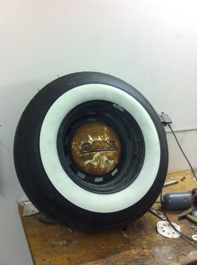

    had a little bit of spare time this afternoon, cause of bad weather.

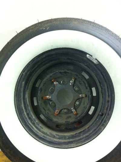

    I wanted to use the old hubcaps on my new rims, but the bolt pattern, where the clips are riveted to the rim wasn?t the right size.

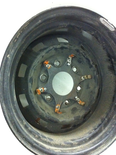

    So took a piece of scrap metal about 1/8 " thick and drew the adapter onto it.
    With a jig saw, i cut along the lines and once done, smoothed it with a grinder.
    A few left over brake pad rivets were used, to hold them in place:)
    Now use some pop rivets or else, to fit the adapter to the rim and ready, to go.

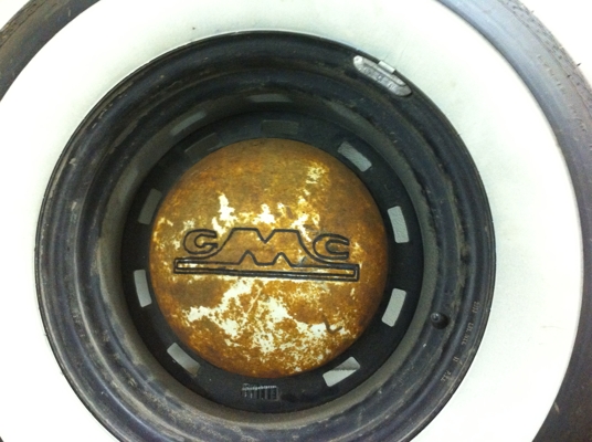

    What do you guys think? I really dig the look of these hubcaps.
    All i need now, is 4 good used crome ones, as all what is left, is the one in the picture...
