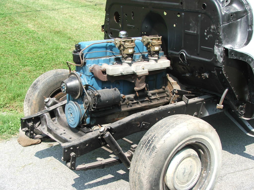

    OK, a while back on another forum I posted trying to figure out which inline 6 I had, and by the numbers I found I was told it is a 292. Now here's my dilemma. After reading several posts here I went out to look tonight at the motor mounts......... there are none!!:confused: The motor is bolted to a front crossmember just behind the crank pulley and the tailshaft of the trans is mounted to a home made cross member. Nothing in between, which leaves me to wonder what to do when I install the T-5 other then use this setup the way it is. The motors side plate is one piece not two, the fuel pump near the front and dist. is further back on the block towards the rear. If this is not a 292 I may go for a v/8 swap, any clue as to what it is?? Thanks

    Can you post some pictures here for us to look at?

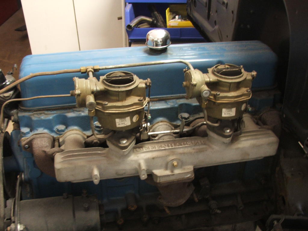

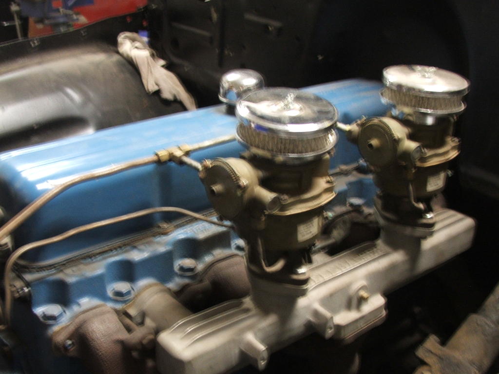

    Get better ones tomorrow, its raining and dark. Top one shows the front mount.

    Lovin the dual carb's! Looks like a 292 to me...
    I was told that one thing you can look at is that is different on a 292 than all other stovebolts is the side bosses for the motor mounts on each side of the block are in different places. In other words they aren't straight across from each other.
    http://www.chevyc60.com/engine/normal_view.JPG
    http://www.chevyc60.com/the_engine_page.htm
    Don't get discouraged, fabbing up some motor mounts wouldn't be that tough, especially since your motor is already in place. Get some motor mounts that bolt to the motor and then fabricate the piece that goes to the frame.

    Your engine is definitely a 235, if it had the larger oil outlets on the side then it would be a 261 but for sure it is not a 292. the 292 would have the side mounts like a v8 and a few other things would be different too....Big Tim:cool:

    Your right, just found a good pic of a 235 and thats what it really looks to be.. *&^%#*&^$*### IT!!!! Now not sure what I want to do!! Gimme some guidance here guys!

    Looks very much to a 235 to me !
    Engine left side behind the starter there are numbers. Your block number will confirm what engine you have and in what year it whas made/plant it came from. Go to Patricks website and look it up there. Patricks sells the original crossmembers for the rear if needed.

    Definitely a 1955-1962 full pressure 235 motor.
    The triangular motor mount bosses cast into the side of the block denote a CAR motor.
    & that means it has hydraulic lifters.
    The valve cover with the filler in the center denotes 1961 & 1962 models.
    The numbers cast into the block behind the starter will positively ID this motor.

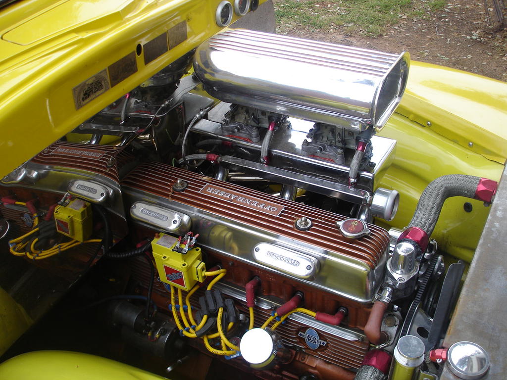

    Love that engine Big Tim
    Is that a Tuffa scoop or maybe a Hillson or shotgun style airfilter you have on top of the carbs. It looks great. What kind carbs are hiding underneath the filters ?
    Martinius.:)

    Thanks Martinius, That's a Hillborn style scoop with 2 350 CFM Holly 2 barrel Carbs...
