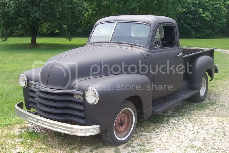

  11. vwnate1
    11,673
    Nice truck ! Love those old DeSoto bumpers , they were the Bees Knees many years ago....
