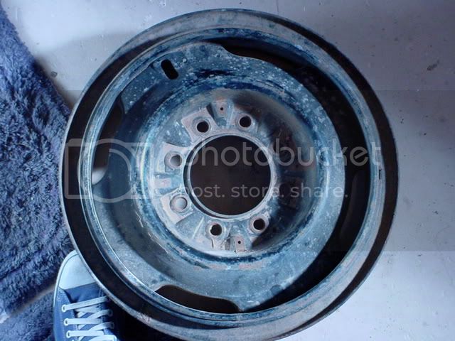

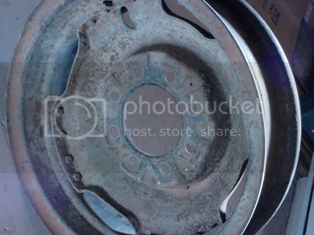

    k, i just realized my tires are a little different than the ones previously mentioned. i have LT235/85 R16s on my truck. and yeah, i'm definately on a tight budget nate, which is why your advice is sincerely appreciated. is it difficult to find people who will put those split rims on there these days??
    jon
    ps- here's some pics just because. ha!!
    front of old wheels
    top of old wheels
    back of old wheels
    and the wheels i'm currently running

  20. vwnate1
    11,675
    O.K. , I finally got back to this page ! WHEW ! .
    Your split rims look to be in _extremely_ good condition . I'd get them re-painted and mounted up if you want to run original typ hub caps .
    There's _always_ a place that mounts split rims , you just don't go to that part of town . any place that does Big Rigs will do them for you or , you can get some sturdy 3/8" _welded_ chain and a couple padlocks (some use bolts & nuts) to make dual loops through the center of the rim and around the tire
    180° apart so -if- it pops your face won't get scraped off by the flying lockring ~ yes , that's what happens to the -lucky- guys .
    I love the last pic as it shows a normal AD working truck , that skid mark used to be on 90 % of them back when they were just ' Old Trucks ' :rolleyes:
