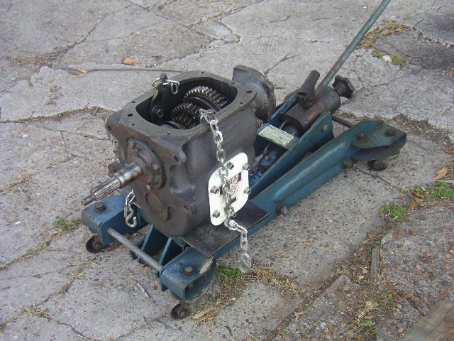

    One of my co-workers posted this question to an e-mail list that I subscribe to (as does Nate). I noticed that there have been no responses, so I thought I'd post it here and see what this forum thinks is wrong with her SM-420.
    My 59' GMC 100 pickup has been driving great for about a thousand miles
    since I put in a new clutch. Then, yesterday, with no warning, the gear
    shift lever (four on the floor) got stuck. The truck is in 1st gear and
    the shift lever moves somewhat fore and aft, but it no longer moves side
    to side at all. The clutch works as normal and there's no grinding, the
    transmission is just stuck in first. There wasn't even an alarming
    sound of any kind when it got stuck, I was just pulling out of a parking
    space when it happened and everything was normal until I couldn't
    upshift. I pulled the shift lever/linkage attached to the tranny top
    cover off this afternoon, and that appears to be where the jam is. Even
    with the cover off of the tranny, the shift lever is still jammed.
    However, I don't see anything obviously broken, frozen, or terrifyingly
    worn on the linkage. Certainly I'm not seeing anything that looks like
    it should have caused such an immediate and complete malfunction when
    all has been great for years.
    Has anybody seen this before? Any thoughts would be appreciated, I'm
    finding this a bit perplexing.
    Thanks!
    Heather

    I'll go out on a limb here...
    Something broke. Probably a Jesus clip or ring thingy. It would be neat if it was just the retainer that held the shifter in place had a tab rust through and let the shift lever go out of whack to where its shaft didn't work like it was supposed to... Wait a minute. I just described ~ never mind...
    That's why I never "pipe" up on issues like this...
    Let me just say, "Good luck!"
  4. vwnate1
    I didn't see it so I didn't respond to it .
    There's not a whole lot that holds the big sliding 1st. gear into place so once the lid is off I'd take my long flatscrewdriver and gently shove it & see what's what .
    Failing this I'd tear it down , they're about the simplest tranny I've ever been inside of ... can't be much wrong with it .

    shifter
    Just a guess, there are two pins, one either side of the shifter, near the top that the shifter pivots on, mine were badly worn and loose, possibly one of these has snapped off and got jammed in the linkage or shifter has twisted and jammed.
