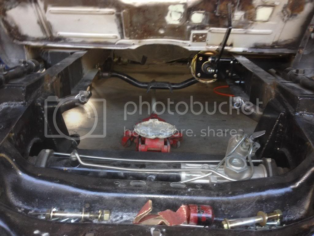

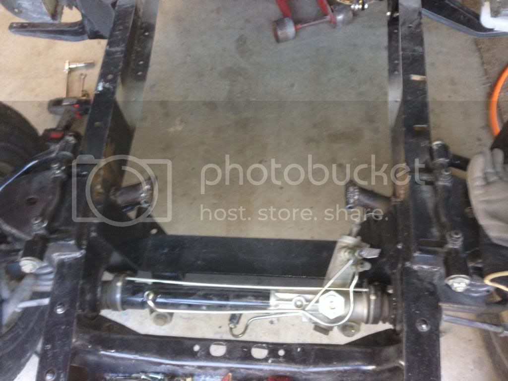

    I picked up a crate 350 an bought some block hugger headers. I was trying to see where I wanted my motor an tranny to go and think I got it where I want, but looking at the headers they are so close to the frame that I don't think they will work with setting up the steering linkage to my mustang II power rack. The headers give about a 1" or 2 and that's about it.

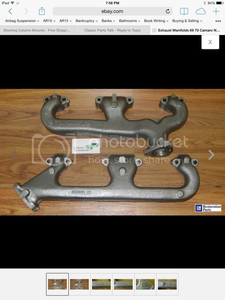

    I was wondering about these? There's a video on the internet with a guy representing Brothers and he's installing a Mustang II in a 1953 chevy truck. There's 6 video's back to back, in the 6th one he talk's about the 69 Camaro headers that are very close to the block and he say's there more room for the steering compared to the hugger headers.

    In these trucks you have to use a 3 joint steering setup. It has a heim joint in the middle and you can get the rods away from the headers fairly easily.

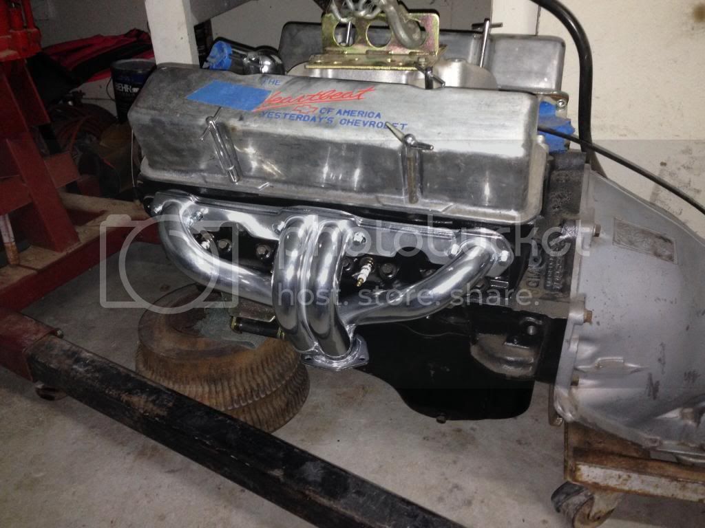

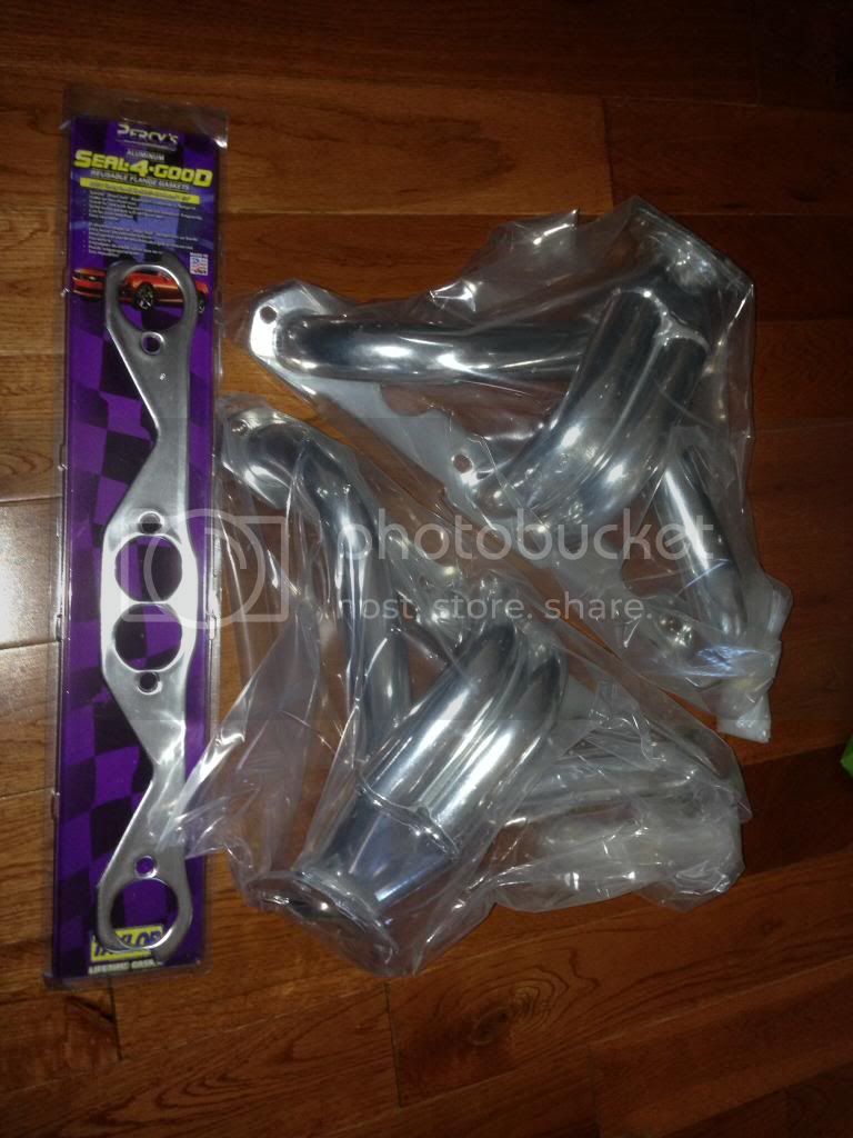

    The headers I have are from Summit, 16gauge and I got the ceramic coated. One thing for sure, they look purty. :D
  7. ol' chebby
    3,167
    Those look good. They have extra reinforcement at the collectors.

    how much clearance do you have between pulsation dampner and power steering rack. It looks close
  11. Ricos54
    Ricos54 Member
    Aug 24, 2013
    334
    CA
    3/4" I wanted to have my motor as low and far back as possible for center of gravity. I think I accomplish that. Lol :rolleyes:

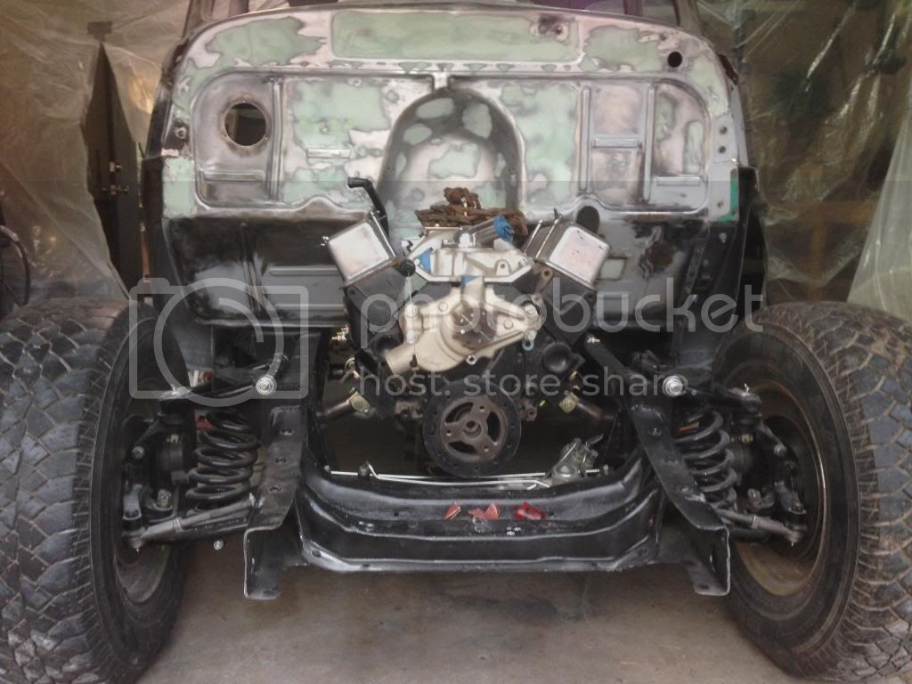

    Thanks Damon, well now another problem arose:eek: I have a short water pump and I went to bolt my alternator up and it hits my valve cover and I can't push it out because it hits my inner fender. I'm lost, what are you V8 guy's doing to set your accessories up on the engine? I want to install a alternator, power steering pump and A/C pump. Are you using a long water pump or changing the brackets to relocate. Any help would be greatly appreciated..:D
