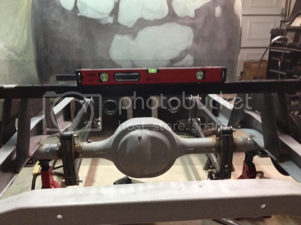

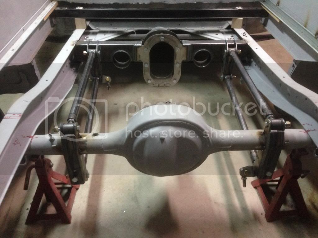

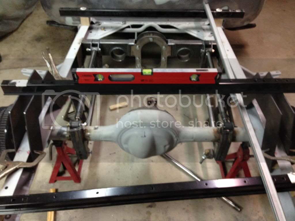

    I've installed a 4 link in the rear. I lowered the frame in the back to be level with the front. Now the frame is sitting on the axle, I would like to install a c-notch to give me about 4" of space for the axle to move up and down. Can anyone recommend some company for c-notches? I was hoping I could find some that would slid over the frame weld then cut the frame to make it easy! I just don't want the c-notch to be to big that I lose some of my bed. I want use the entire bed and keep the c-notch below the bed rails.

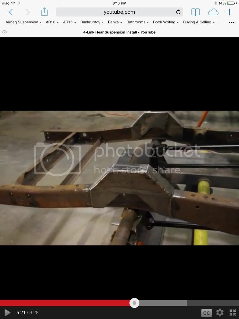

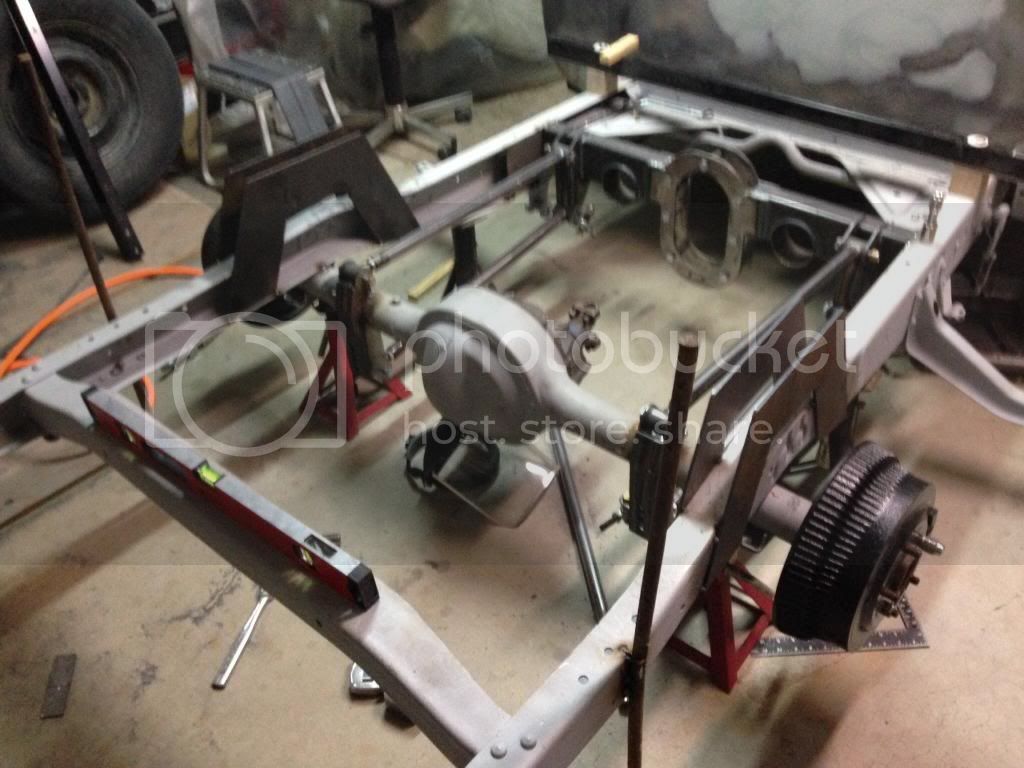

    Yes I plan on using coilovers and the pan hard bar will go diagonal from the rear mount across to the front mount. You can see the hiems on the bottom. And the rear end is at ride height in the picture.
    I was wanting something like this, maybe a little higher off the top of the frame

    I would go with a step notch and box the rear of the frame. If you have a bare chassis, these trucks benefit greatly from a full frame boxing. Box at minimum 1 foot in front and behind the step. I like putting in tubing, then boxing over that with a 1 piece plate inside and out. Overkill, maybe, but I mke shure mine gets me home. I had a step notch before I went IRS, it touched the bed floor, the pumkin would just hit the wood when completely aired out.

    As ol'chebby stated that is a step notch. They are available from lots of places, do a Google search and type in "step notch": here's an example http://thorbros.com/notches/8-pc-step-notch-kit-sold-pairs
    You can modify the height based on how you install it. I agree with ol'chebby, boxing the frame is a must. I'd suggest you box your frame from just ahead of your four bar crossmember all the way back past where you will be mounting the coilovers and panhard mount. The coilovers will load the frame behind the step notch so the notch will see significant loading.

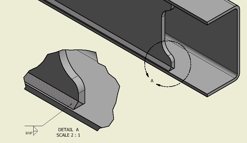

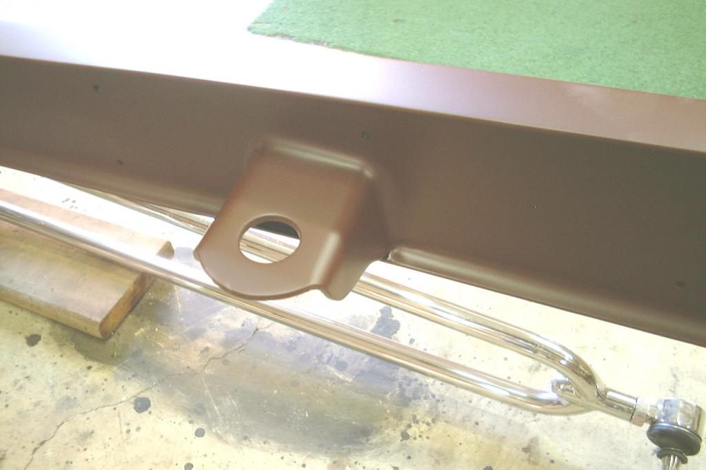

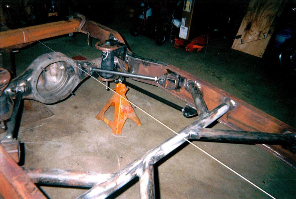

    Here's how I prefer to install boxing plates, by using a groove and fillet. It ensures a more uniform weld and is easier to fit up and weld than a corner to corner weld. And the scallop at the end of the boxing plates helps minimize stresses. It looks pretty cool too after the install.
    I used the inset boxing plates on my '27 RPU, got the idea from a So-Cal Speed Shop rolling chassis I saw at the Street Rod Nationals back in the late 1990's.
    Here's some archive photo's of my '27 RPU frame:
    Hope that helps!​

    I got the 4 link and crossmember off eBay from a company called Danny's Original Customs out of L.A. I did check out Thor but after shipping I was looking at $180 to get it to my house:eek:

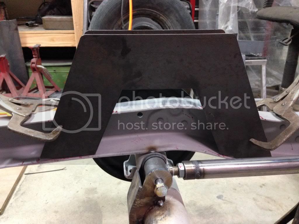

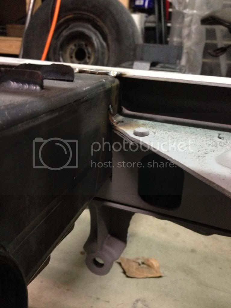

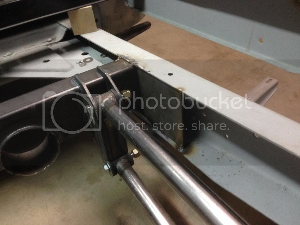

    Thanks for the advice O'Chebby and Lakeroadster, I ended finding a company right here in my town for the c notch for $100 and it's a 8 piece so I can modify it the way I want. They are taller than I wanted, but I decided to leave it in case I decide to bag in the future I will definitely box it in in front and behind the c notch. Thank you guy's :)

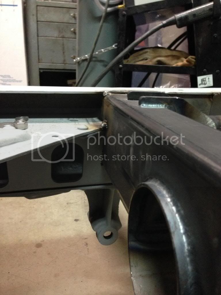

    I also cut a shelf out of the stock crossmember behind the cab so the 4 link crossmember would be boxed in around it and then I put boxing plates behind it too.

    3/16" thick and 4" wide:D

    Thanks, got them tac in today. The caps that came with them weren't wide enough for me so the guy is cutting some new one's for me 3 1/4" wide so I can have a lip to weld them together on top and inside the C notch. I'm also getting some boxing plates on Monday which I will tac everything in then taking the frame to my friends house so I can weld everything up with his 220 mig :cool:
