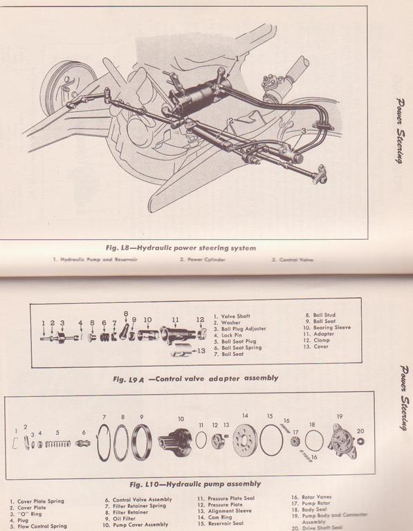

  4. Kens 50 PU
    Zig, this is what Evan is talking about
    Here's a diagram of the combination generator/power steering pump.
