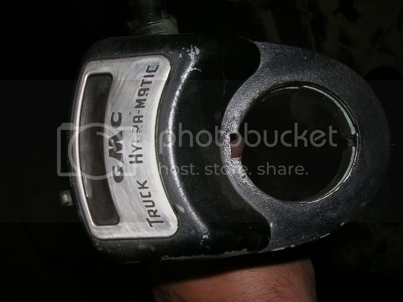

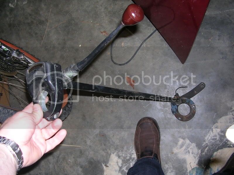

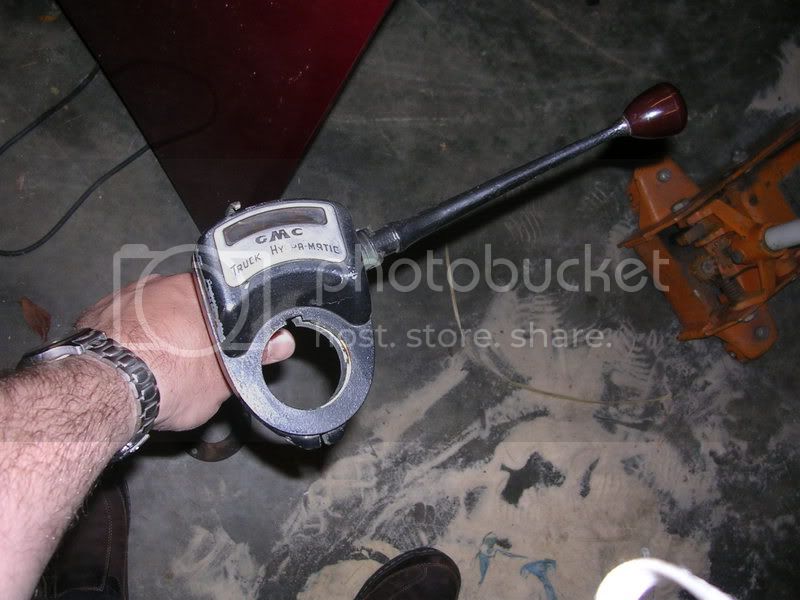

  8. ol' chebby
    3,164
    Here it is... finally. Don't know much about it, it shifted a turbo 350. All parts seem to be there, including another bracket not in the picture.
