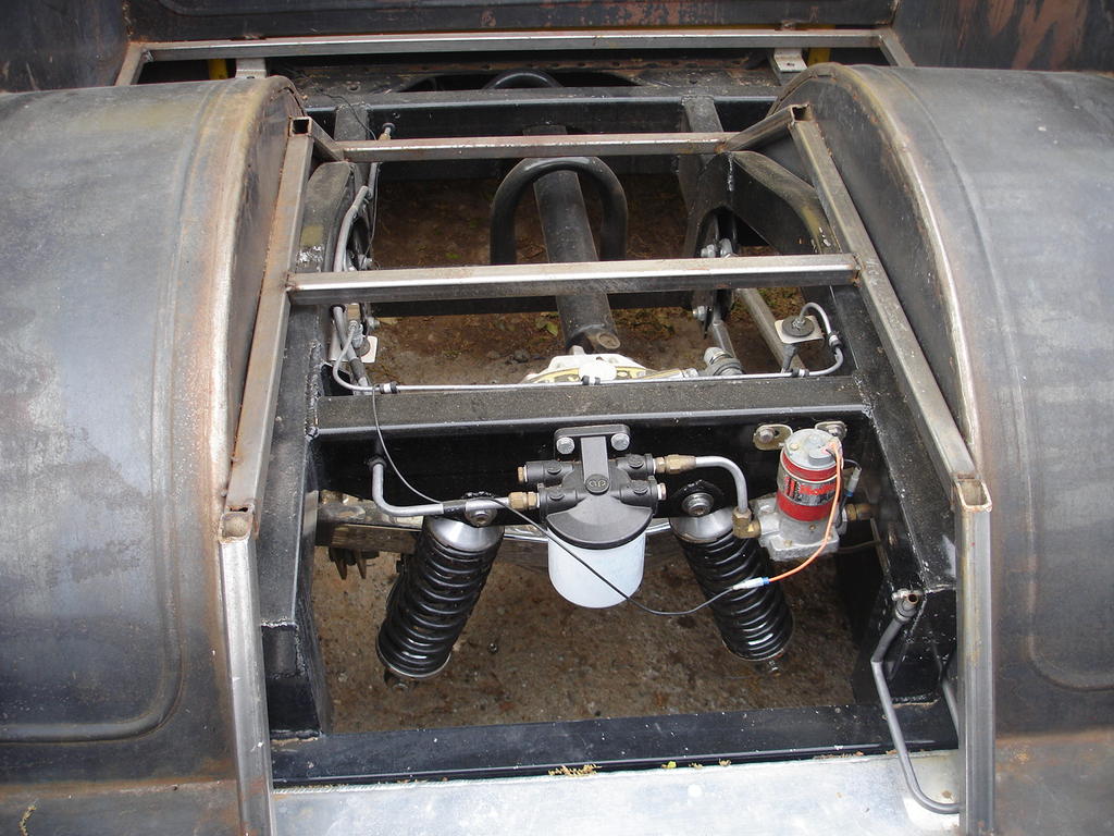

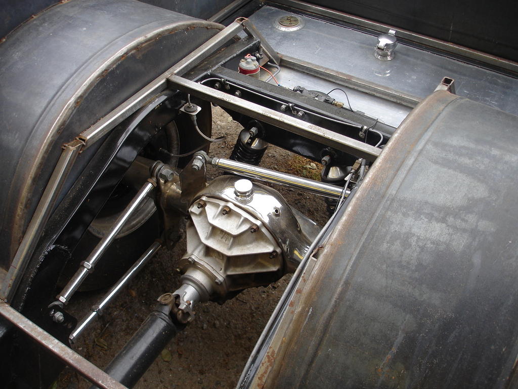

    Are you planning on making a hod rod out of your truck? If so a 4 link is good, the ride is stiff and there is less sway. If you change the suspension in the front you will end up with almost zero sway depending on what you do. If you are just planning on making a daily driver or a hauler I don't recommend the 4 link. Here's some pix of my 4 link, I'm using a Jim Meyer front end with tube a arms ,Avo coilovers and a mustang rack in the front. This truck is very stiff, has no sway and since there is no rubber in the suspension just rod ends, all the power go's to the ground. This truck handles like a sports car. Lots of fun to drive.

  3. vwnate1
    Fwiw ;
    The lack of rear sway is due to the Panhard Rod , nothing to do with the 4 link suspension .
    That looks really nice .

  5. bigtimjamestown
    bigtimjamestown Member
    Jan 11, 2010
    683
    Jamestown Ca.
    Thanks for the compliment and you're absolutely right about the panhard bar, but the stiff ride comes from the American coilovers and the fact that there is no rubber in the suspension. I've experimented with lots of different ideas through the years and I remember when I used to run around with no bed on the truck and leaf springs on the back. I could look out the back window and see the leaf springs flexing every time I stepped on the gas. Traction bars helped but the four link really did the trick. The truck launches strait as long as it's sitting strait but if it's not look out cause if you don't back off the gas it's all over the road. :eek:

  7. vwnate1
    I assume you used Polyurethane bushings ? I'm quite fond of them .
  8. bigtimjamestown
    Jan 11, 2010
    683
    Jamestown Ca.
    No polyurethane either, all aircraft rod ends on the four link and on the upper and lower a arms. :)
