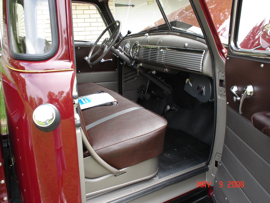

Did Chevy make the interior garnish moldings for the doors out of stainless for the deluxe models or were they just chromed?
They were stainless and they can be polished out with jeweler's rouge and sparkle 50 years down the road. The glovebox on most, but not all trucks, was also stainless. The above photo is strictly for educational purposes and is not intended to be a blatant attempt at showing off Ken
