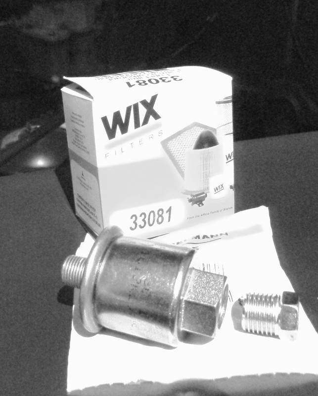

  13. Tubby
    Tubby Member
    Oct 12, 2012
    100
    mockoski
    Didn't mean to steer your thread away from your original question.
    But yes you do need the hose.
    One end is 1/8 inch pipe the other is inverted flair to attach the the hard fuel line.
    My experience is that a added fuel filter under the tank is a good idea. But it will need to be changed out . So if you don't have a working shut off valve or not comfortable changing fuel filters then it may not be a good idea.
    There was not one there originally.
    One has been under my tank since the early 70's
    They do work . Here is a pic from a clear filter I used for a few months
    [​IMG][/url]
    It picked up some pretty big particles.
    That's with a new tank. So those particles came from the gas station pump.
    I quit using that style filter and went back to a canister.
    Even with that filter I added a second one at the carb.
    A few years ago I was experiencing some flooding issues.
    With the filter under the tank I was still getting small particles under the carb needle.
    Since I added the second filter at the carb I've had not other issues.
    Not fun to be stuck on the side of the road clearing a carb.
    There are period correct clear filters that can be used inline.
