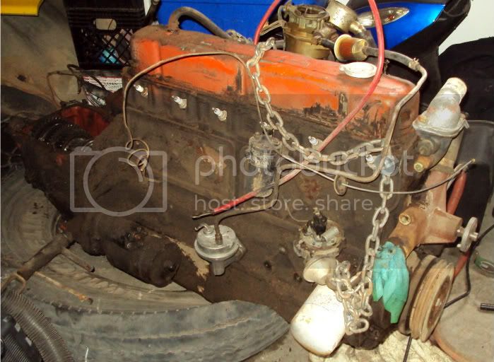

    I have one that is a 1968 and this one was in a 1968 truck of the same ilk.
    However, mine does not have the "Chevrolet" logo on the valve cover, etc?
    My carb is different too.
    Codes # 4886 - 2706
  2. vwnate1
    11,666
    292 C.I.D. Thinwall L6
    Yep ~ that's it ! .
    I need the hose to aircleaner thing hanging got my '69....
    What are you going to do with this engine ? .

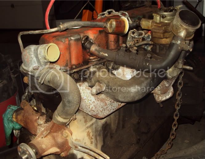

    By The Way ~
    That carby is a Rochester 'B' series , used up to 1967 on 292's , in '68 they went to the Rochester Monojet .
