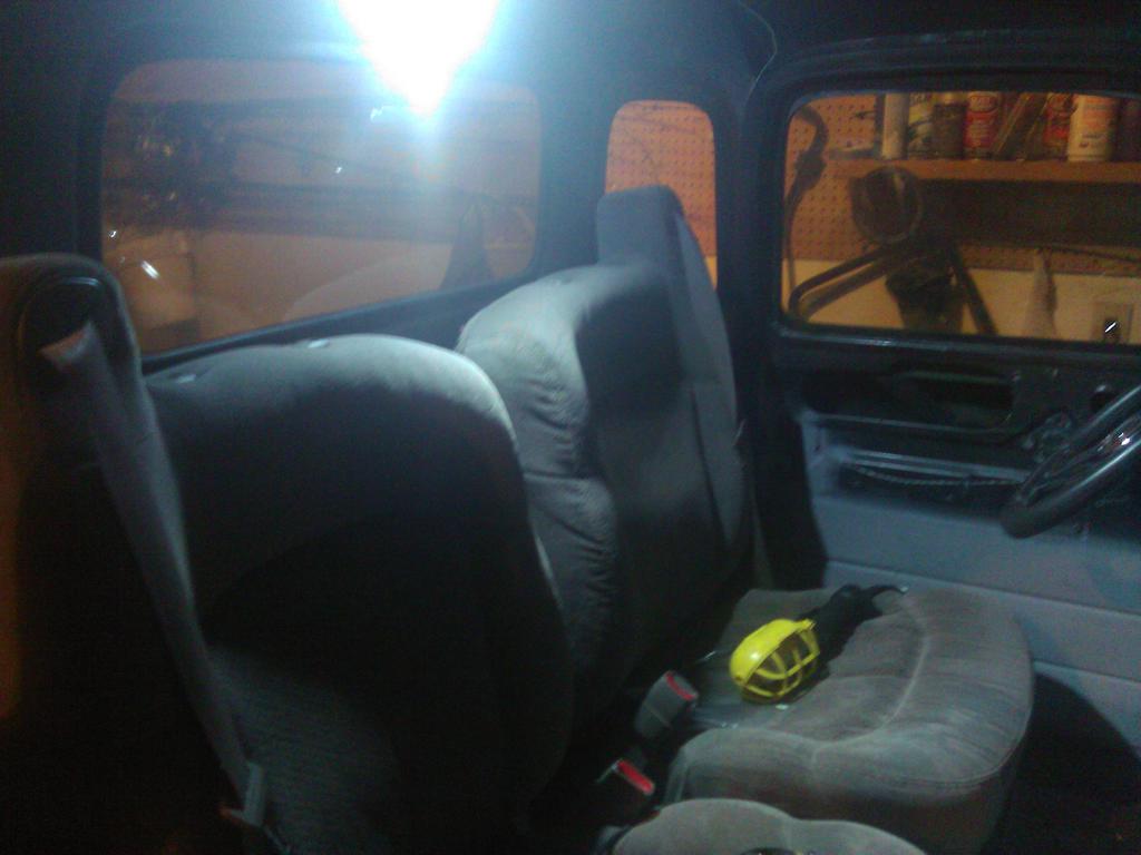

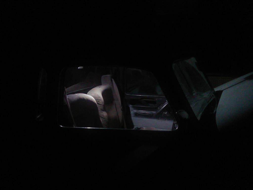

    Changed the dome light to L.E.D. Man, this thing is bright!!

    I think u can put your work light away now :^) :cool:

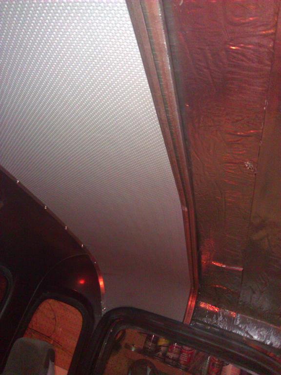

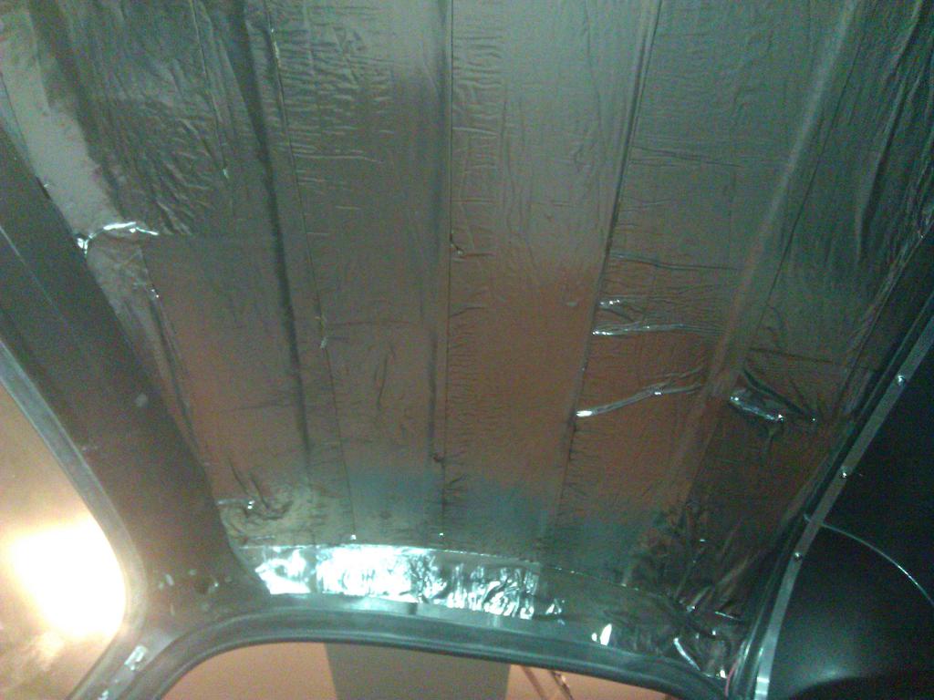

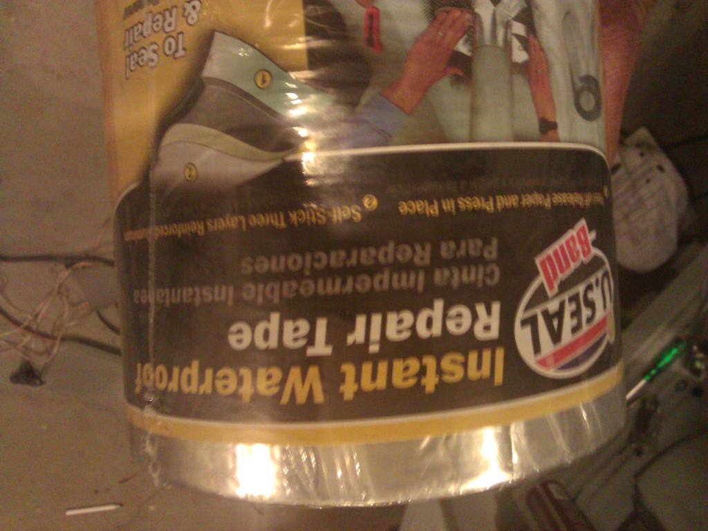

    Zig, someone (I can't remember who or where Isaw it) used this stuff to insulate their cab. it's a tar based roof repair tape. One side's super sticky, the other's aluminum. I used it on the roof and more than likely under the door panels as well. I got the rear of the headliner in but this the front panel's a bear to install!
  14. Zig
    Robert, that looks mighty fine, so far! Did you apply a fabric over the top of the cardboard?

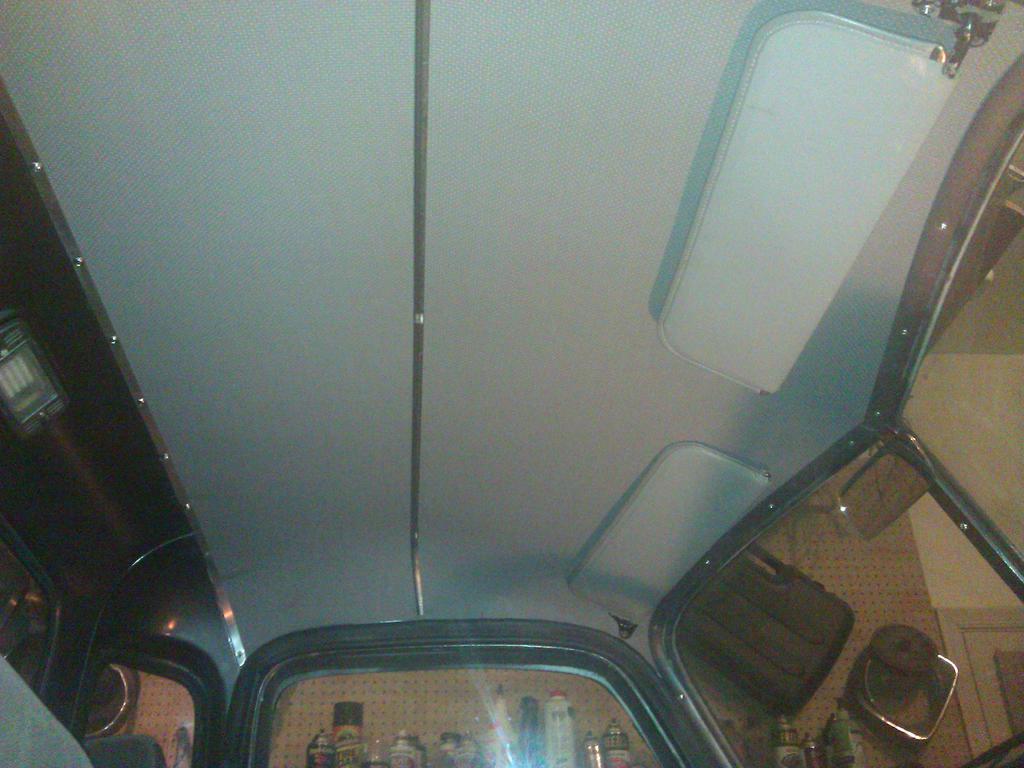

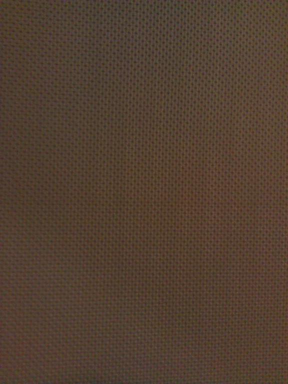

    Thanks Zig, I ordered the headliner and center bow from our host and covered it using some material I had laying asround. Didn't have any luck fiding a rear bow so I found a half inch aluminum strip at Home Depot and made my own. Finished it up tonight.

    Robert, if you have a few more photos, could you do a thread on "How to install a head liner"? I love the idea of wrapping the cardboard. I assume that the wrinkles that show up would never be seen, and it would add more sound deading material inside the cab. That just looks fantastic! I'm starting to get the idea that maybe this way isn't that bad... Nice fit, also!

    Thanks Zig but I really dont have enough pics to do a thread. I'm not even sure I did it right and it's not perfect by any means but it'll do for me. The wrinkles on the sound deadner wasn't a big issue because like you said, they wont be seen. This is what I did:
    1. After gluing the material to the board I slid the center bow onto the rear section of the board.
    2. Attach the rear bow (in my case a 1/2" aluminum strip) but leaving it loose enough to allow enough room for the board to slide into.
    3. Slip the rear section in and tighten the screws on the bow.
    4. Slip the front sention into the bow; curse abit; take it down; put it in again, try to adjust, curse, do it again. (repeat four times)
    5. Give up for the night , try again the next evening.:mad::mad:
    6. Day two, repeat step 4 until you get the both corners to stay in.
    7. Install the windshield trim. ( I had to trim the board som to keep it from sticking out from under the trim piece.
    8. Install the sunvisors.
    9. Breath a sigh of relief!:D:D
