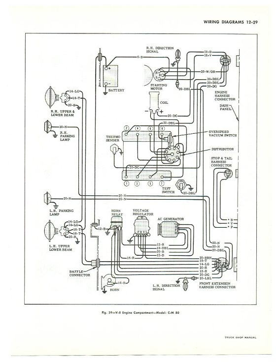

    Whats up guys?? got in my truck the other day to start it up and it would'nt start. look under the truck and found what I believ to be the ground wire off the starter has somehow got cut? problem is where does this wire connect too?? I know it comes off the starter but then where?? thanks in advance!!!!!

    Check out this old post I dug up about starter wiring. It has wiring diagrams.

    there shouldnt be a ground wire to the starter as far as i know. just he big wire from the battery, then the small one from the ignition switch. the starter should be grounded through its body to the block. though im used to dealing with newer then 60's engines. mine is a 74 400. the fat wire from the bat goes tothe large post on the starter, then the ign start wire goes to a lil clip on the starter. use a voltage checker and have someone turn the key while testing that wire to see if its the start wire. if its really skinny it prolly is. if its fat its prolly the power cable.

    Thanks drabo I got the link but not sure about the wire; gonna have to pull the starte ; headers are in the way. even still I have not found the other end of the wire?? thanks you too williamb82; the motor in mine is a 283 not sure of the yr. and yes its the skinny one on the peg closet to the block look everywhere still cant find where it goes??

    There is a 6g black wire that goes to the center nipple on the soleniod.Good Luck.

    check the color of the wire. it may be purple. starter facing you, solenoid on the right. It leads to ignition switch.

    bottom nipple.

    well its not a ground wire problem; got the wire hooked up and still nothing
    I think its got something to do with my ingition; truck does not even want to bump or anyhting but, everything seems to work just won't start???
