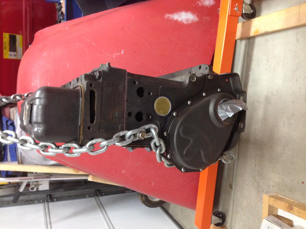

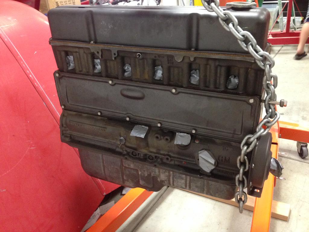

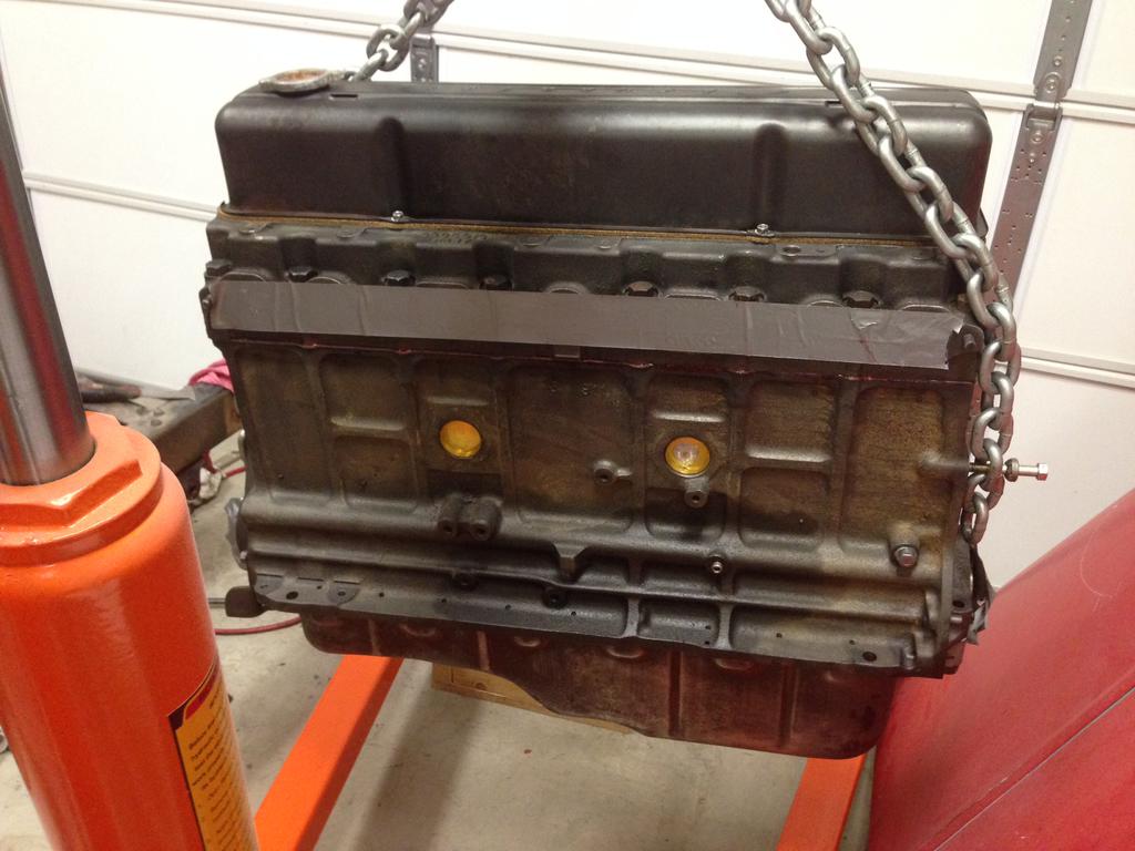

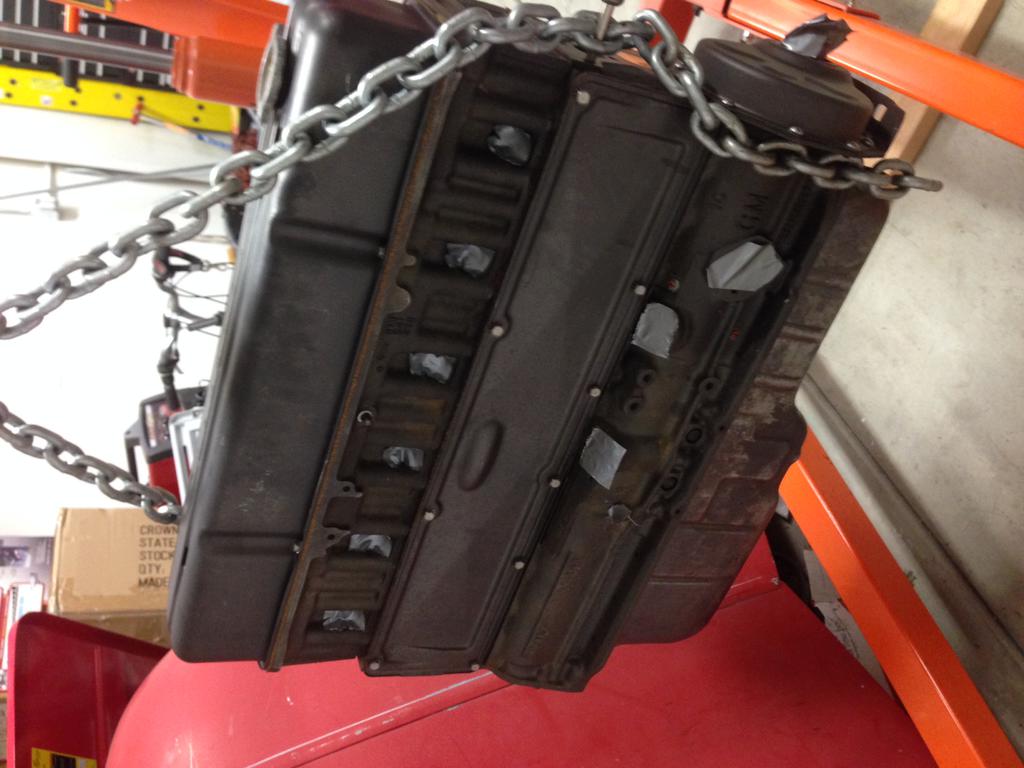

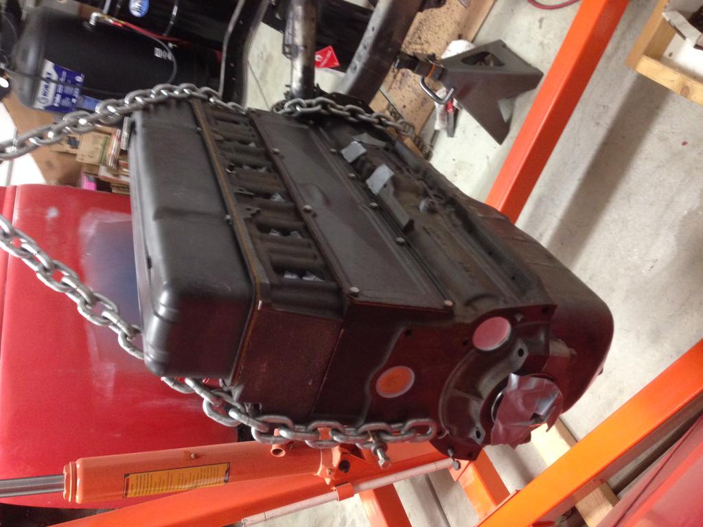

    Finally got around to picking up the engine from the rebuild shop after it was stored there a very long time.....it is a beautiful thing!!!!
    Now to restart the debate as to what color it should be painted....or have we all come to terms that gray is the right stock color for the '54??? :D

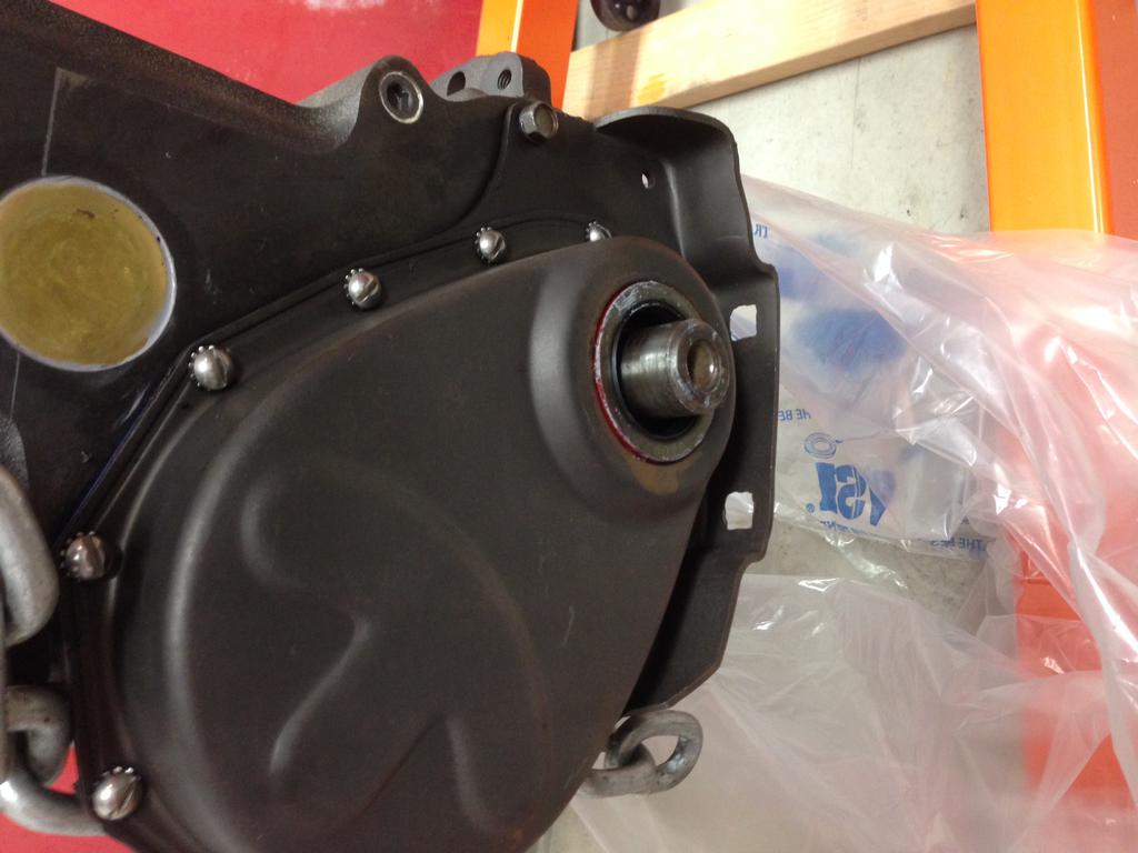

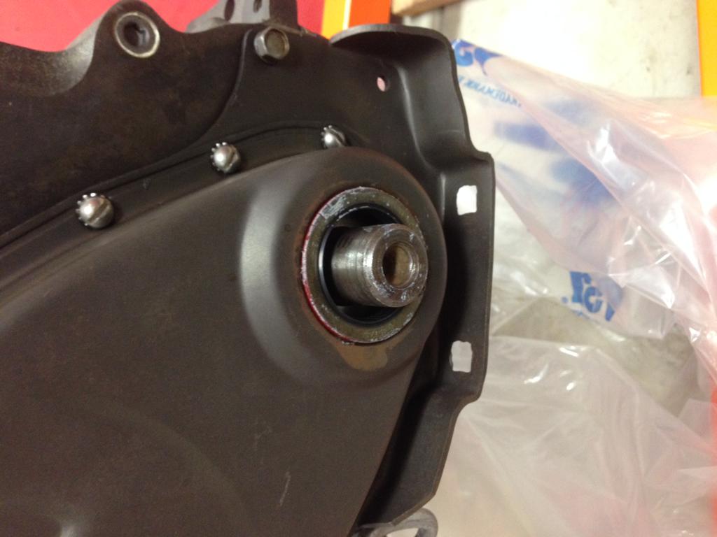

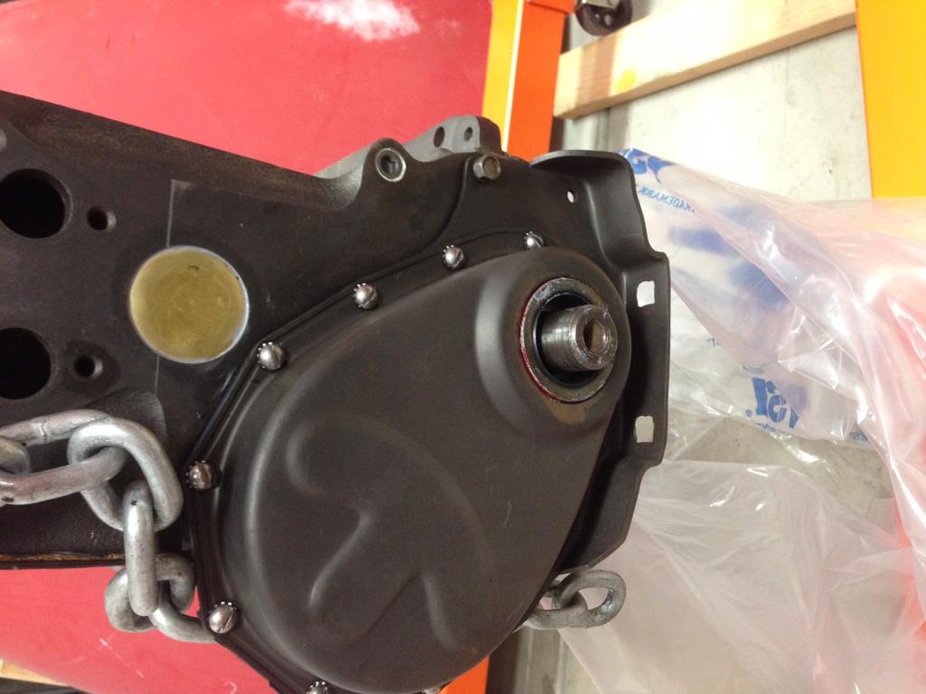

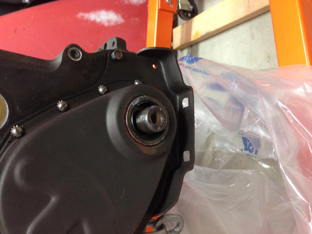

    Russ - now you have me a little worried....
    Russ - The front of my engine where the mount goes looks the same as it does when it had the 235 cam. Same holes for the front mount (except a lot cleaner). Is there something I am missing or was something done incorrectly? :eek: I didn't watch them do it but I am pretty sure they put in a 261 cam. Pics attached.
  12. ol' chebby
    3,167
    Then you are good to go!
    Many of the other engines had mid block mounts, but can be modified to use the front mounts.
