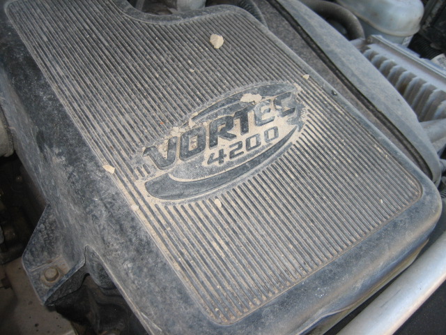

    Finally, FINALLY, got some pictures uploaded on the windows 8 machine and will try to post.
