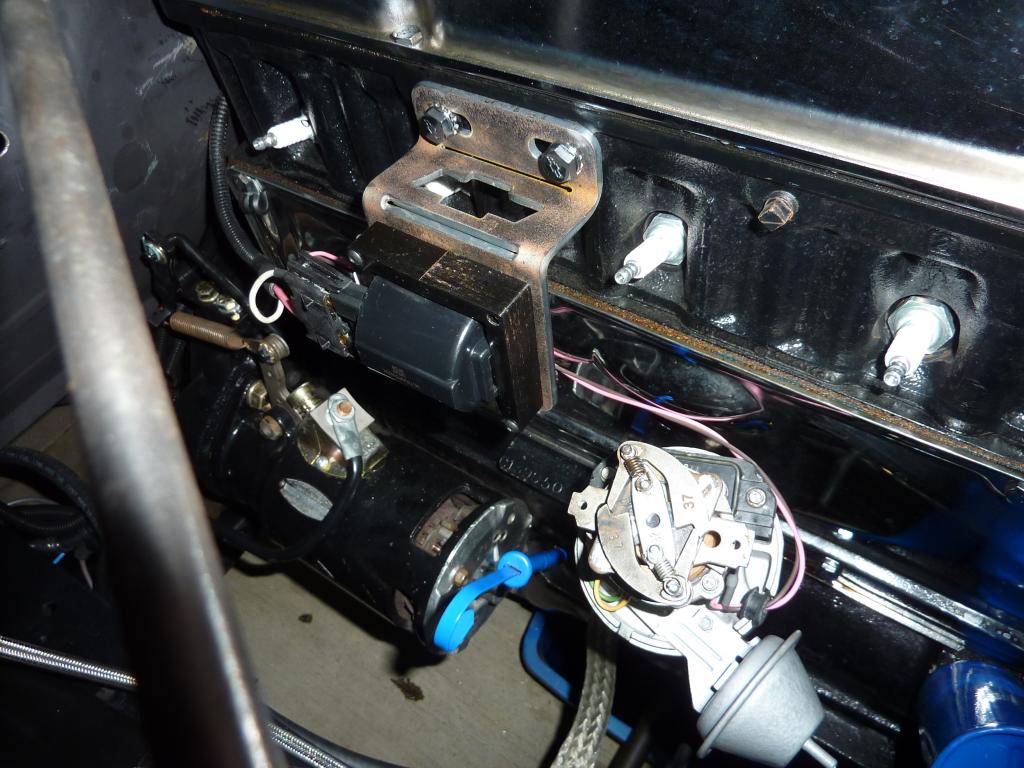

    Did my Mini HEI install a few days ago. After sorting out my carb issue I moved onto something new. Previous setup was a Pertronix system that worked fine. Worried about something busting and not finding parts easily is why i really wanted to change to HEI. The unit I got was from Tom L. Install was straight forward and only took about an hour.
    Before starting I made notes and observations on how the truck was setup with the Pertronix. I was running the timing at 10 deg and all is running smooth and power is there at the mid to high rpms. Starting was easy and idle seemed smooth at 500rpm. Truck would hold this faily close with the dash tach and the timing light tack slightly bouncing by about 10ish rpm. Pertronix coil would always get super hot and the stock dizzy had the slightest wobble to it as it would rotate (kinda funny to watch) The spark plugswere gapped to .038 and are NJK BR9ES.
    First thing i did was find my #1 tdc and that was easy as i marked my distributer before and made sure down was #1.

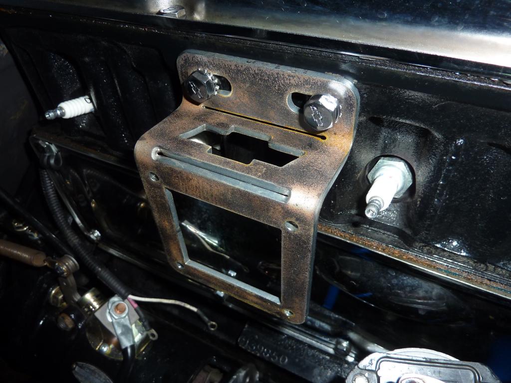

    Next was to remove the old distributer and old coil. I made a fast bracket to hold the new coil. Will make another one soon with hidden bolts, solid bends and chrome finish. The bowtie alone adds 5 hp.

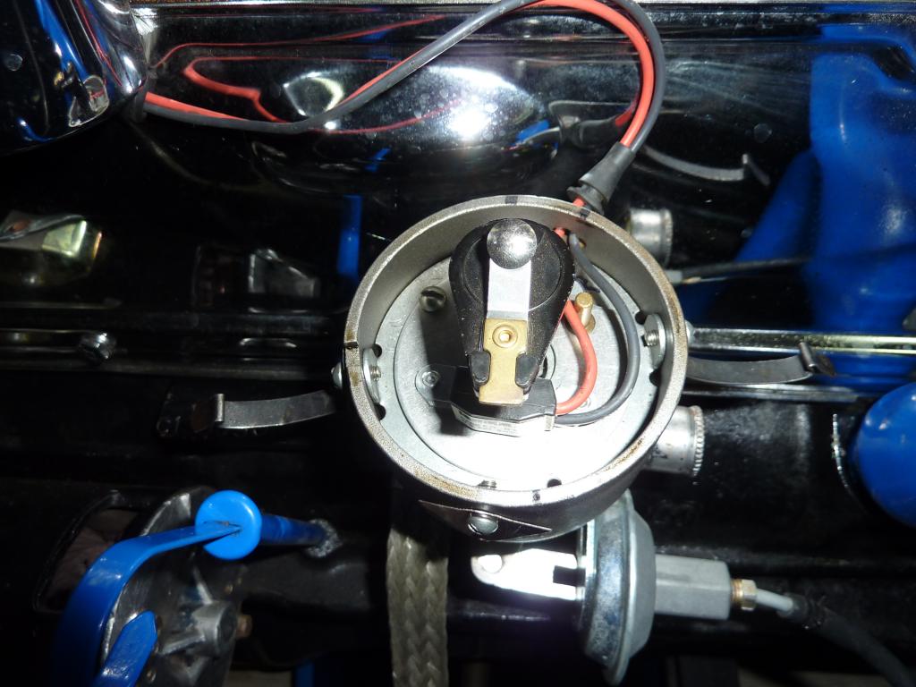

    Installed the new coil and distributer. Next was to change over the wire ends so they would attach to the new coil tabs. Once that was done the coil was rotated and positioned as required so the pickups would line up. The unit was then bolted in. The old plugs were removed and the new ones installed. All gaps were checked and all came in at .060.

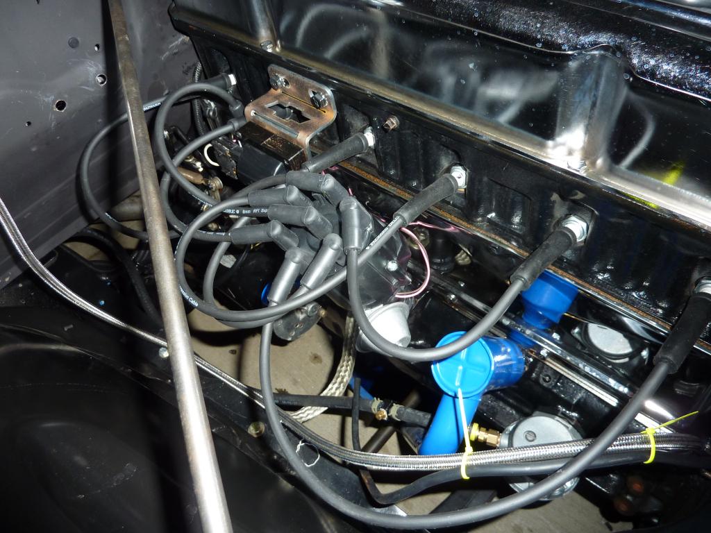

    After that is was a simple 5 min to install the cap and the new wires Ialso got from tom. The reason i got new wires was so i could do the swap quickly and not have to redo the ends on my current 8mm wires to fit the new cap. The new Black wires are also 8mm. I will now change over the ends on my existing blue ones and reinstall them one day.

    I like the coil bracket , I assume the cutouts in the bends are for stress relief ? .

    Here's the deal~ The bolts are the eyes, the Chevy emblem is the nose, and the last cut out makes the "cool with the world" mouth.

    I have a similar coil bracket on my old Russian Moto and it keeps cracking or breaking in the bends , I was hoping our slots were a solution to it .
