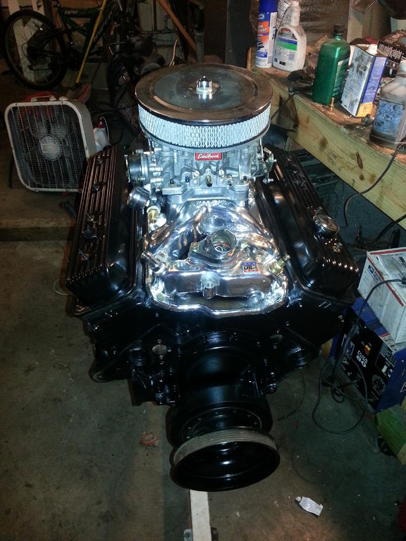

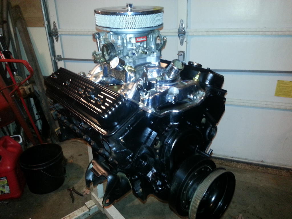

    Here you go Zig. Still undesided on which type of fuel induction to use. I like the idea of the versitility of fuel injection, especially since I finially figured what was wrong the last time!

    Dang that looks pretty, Robert! Did it come painted up, or did you do that?
    Are you going to have to change motor mounts for this swap? How about hooking up your transmission?
    Good luck with this and I hope you have some time this week to work on it!

    Thanks Zig. I cleaned it up and painted it myself. I'm gonna use the mounts and flywheel from the 327. The tranny should bolt up without a hitch.
    Steve, we'll see about that.
